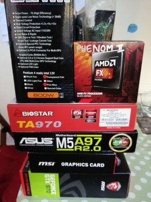

As I have a spare Phenom II BE 365 3.44ghz. I'm thinking why not recycle what spares I have and make a reasonable XP rig. It is however a 125w CPU , not sure if the stock PSU will handle it. It's probable only a 350w.

Reply 18 of 23, by Hiddenevil
As I think I stated from the beginning, the plan was to replace the socket A. Yes I'd like to leave it as is, but I want to balance retro gaming support with usability as an everyday daily driver. Which is why I'm doing a xubuntu / Windows XP build. One modern OS for going online and the other for backwards compatibility.
So I dug through the closet and found this stuff I've been hoarding.
