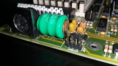

I have added a battery to this hybrid 386/486 VLB motherboard but it doesn't still hold the CMOS data 😕
Should I add any components to it e.g. diode/resistor?
https://pics.meshok.net/pics/131995499.jpg

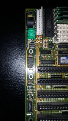

Reply 4 of 14, by RiP
derSammler wrote:
You need a diode and have most likely installed the battery not correctly. Show a picture of what you did.
Should I fill D2/D3 and R22? 😕

Reply 6 of 14, by quicknick
Your board did not have a rechargeable battery. The battery's positive goes to an empty spot for a diode. You can use 1N4148 for the diodes and you also need to populate R22 but I don't know the value. That being said, why do you insist on a barrel battery? That's destruction waiting to happen...
Reply 7 of 14, by Horun
Wow thanks quicknick, yeah just noticed it is a Ni-MH which is never used in computers AFAIK. Those diodes and resistors would only help to recharge so the battery must not be charged at all or else it would still hold cmos (if a Lithium or Alkaline was used then no diodes/resistor needed). Trickle charge rate for NiMh is typically 0.05-0.1 of it's max ouput so for a 60mAh it would be 3-6 mA. Assuming ~3.6-3.8v after diodes then a 1k resistor would work. All the images but one of that board (Google) show no on board battery so most were used with external. just mumbling on...

Reply 9 of 14, by Horun
One thing we know for sure: the board had a battery, whether external or onboard. CMOS typically draw 4 to 10uA to keep settings so even if a 1k resistor is used it would supply 3.6mA max to the cmos which is more than enough to keep it alive and not damage it.

Reply 10 of 14, by Tiido
D2, D3 and R22 are gonna be necessary. Diodes should have lowest possible voltage drop and resistor is something between 150...270ohms, setting the charge current for the battery.

Reply 12 of 14, by Tiido
That's the resistor values seen on all the existing boards I have had access to, most have 150ohms, some have 220 and one had 270ohms. They did have NiCd batteries originally though.

Reply 14 of 14, by RiP
Peter z80.eu wrote on 2022-12-06, 14:16:
@RiP - it's a long time ago, but meanwhile I got the same problem. Did you added the 2 Diodes and the resistor, and if, what resistor value have you taken (e.g. 270 ohms... but I would start with the highest to be considered value always) ?
Yes, I used 1k resistor and it worked.
