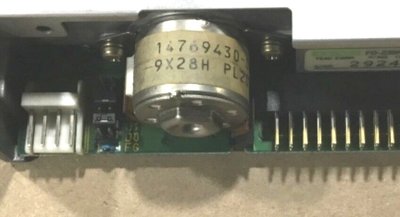

I just got a Teac FD-235F 100-U drive -- 3.5" 720KB that won't read or write disks. It seeks fine on bootup, and will respond to commands, but (for e.g.) trying to format a disk just results in a track 0 error.

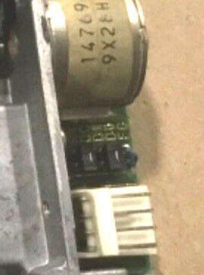

I think it may have been used for something non-PC (Amiga?) because the D0 jumper was set when I got it. I'm having some trouble finding a jumper reference for this particular model, so I don't know what exactly the pin positions do WRT Ready and Disk-Change signals on what pins. Here's what it's set to now:
  o   o   MS
o o IR
| o | o RY
| o | o DC
| o o | D1
o o D0
I found one picture online where the vertical jumper was set to short the RY row instead, with nothing on DC. This just caused DOS to report that the drive wasn't ready, so I assume the above is correct...? But if that's the case, I think the drive might be toast. 🙁
Just wanted a second opinion before I assume a less-than-common model is beyond salvaging. I have, of course, cleaned the heads. Have not yet tried cleaning and re-lubing the worm gear, but it all looks relatively clean and the drive sounds nice and quiet in operation.

Yes sounds like Amiga if D0 was jumped. I found a picture off ebay and zoomed in shows just D1 and RY jumped.
added: found the reference to RY-DC vertical FD-235F-100, is for an Amstrad/Schneider. Korg uses straps on RY, DC and DS0 with a note that you must change from DS1 "is for PC's"

I found a 1992 .doc from Teac which gives the straps (jumpers) for 235-100 and it is just like you mentioned SirNickity
"FDD-235-100/112 Jumper Block: D1/1-D1/2 and RY/1-DC/1 must be shorted." I attached the docu

Alas, I guess that means it is an issue with the drive. Will have a go with replacing the caps and see if that changes anything. There aren't many, but it looks like they're a little smaller than the generic ones I keep on hand. Might have to rig something up just to see if it makes a difference - I really don't want to give up on this drive. 🙁

Indeed -- you guys just saved a perfectly good floppy drive. There are three 22uF (notably, bipolar) electrolytic, and one 4.7u (polar) electrolytic. The latter measured 2nF when I tested it out-of-circuit. I replaced them all with spares and it works fine now! 😁
Will need to order actual replacements though. These are really small, and my bipolar caps are HUGE in comparison. It won't fit in a 3.5" bay as-is. Heheh
