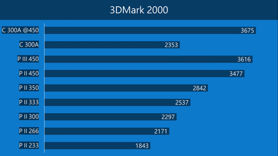

134.28 KiB
456 views
While the PII 400 is not mentioned on this, I'm going to assume it scores around 3159 3DMarks, with very basic averaging math I did between the PII 350 and PII 450. This is with a nVidia Quadro2 Pro, a card that I assume is faster than my TNT2 32MB. This isn't the end all be all of benchmarks obviously, but Phil does a good job with consistency with his benchmarks, even between different videos. This coincides with what I've read online: the full speed cache, even if it is only 128KB, is faster than the half-speed 512KB of cache on the Pentium II line of CPUs. This gives an overclocked 300A an edge against a Pentium II 450, let alone a Pentium II 400. This is the same principle that gives Pentium III Coppermines such an edge over their Katmai predecessors- the cache is cut in half, at 256KB, but it is so much faster because it matches the processor's clock speed that the Coppermine's absolutely kill the Katmai's.
I use 3DMark 2000 as a prime example because I will be running hardware accelerated DirectX 7 (in OpenGL mode, of course) games under Windows 98, and I have found that 3DMark 2000 coincides well with results I might expect from Half-Life, the game that this build is essentially being created to play. Ideally, I want this to run at a minimum of 800x600x32, with full OpenGL hardware acceleration (no software spirtes, etc.), while retaining an average of at least 40FPS. Half-Life WON will always have frame drops and performance issues, this is something that I know I'm not going to be able to fix without ditching era-appropriate hardware, but at the moment it runs well even at 1024x768 with my PIII Coppermine 600 and my 3D Blaster. It just is unfortunate that the Coppermine is more Y2K era than 90's era, so I have to find alternatives- I just want those alternatives to perform as close to how it performs now as possible. I remember that with the PIII Katmai 500, this machine was even able to do Quake III at 1024x768x32, medium to high settings, with the same 3D Blaster/TNT2 card I have.
Eventually, I will have to grab a Voodoo 3 3000 or a similar card, as even though that is closer to 1999 era, it will absolutely demolish Half-Life at even 1024x768, likely better than my TNT2 can- while still having been made in the '90s, whereas my 3D Blaster was produced post-Y2K.
Don't get me wrong, however, I am still seriously considering sticking with my 400MHz Pentium II, as it may be just enough to do what I want it to without the risk of overclocking the processor.
I also don't want a Pentium II 450MHz in there- every single '98-'99 machine I see on YouTube uses a friggin PII 450, and I'd rather not be that conformist- I like to be that way with quite a few things, but I feel like the PII 400 would have dropped in price when the PII 450 came out, allowing people to buy it for cheaper than when it was new.
I just fear that it will bottleneck the 3D Blaster, because with the Coppermine being a full 200MHz faster than that PII, with SSE, and full-speed cache, there is no way it isn't at least be faster than the PII by a large margin.

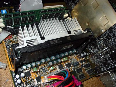

B) I hate all of my Slot 1 coolers. They force you to place tremendous amounts of pressure on said exposed die when both removing and installing the heatsink, especially during the latter stage. They look like this:
132.17 KiB
427 views
No. I said never again with the Coppermine, but now I really mean never again. No. I hate this I hate this I hate this.
When I first put the Pentium II in the system after doing that and being sure I broke the die, I plugged it in and the system immediately turned itself on. Not good.
Unplugged it, plugged it back in, it did the same thing.
Then I set the configuration jumper on the motherboard to accept a different CPU. It started doing two short beeps and one long beep, and the floppy seek was much longer than usual, and sort of glitchy. Then I set it back to normal mode and it POSTed. What the f*ck?
It detected it as a Pentium II 400MHz, it's in Windows 98 SE, right now, showing the 3D pipes screensaver, and it ran GLQuake.
I know this is a stupid question, but I am incredibly stressed about this kind of thing- does it work? Is it alright to be comfortable with? Did I possibly crack the die putting 300,000lbs of force on those stupid little clips to get them to interface with the card properly? How do I test if the CPU is 100% okay? Did I break the die and now it's just thermal paste and pressure holding it together so when it gets jarred in the slightest it will come apart and be destroyed?
I hate these stupid cooler designs I hate these stupid cooler designs no exposed dies are bad
