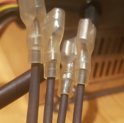

I am trying to figure out how to connect an AT psu to a case switch. I know something bad will happen if I connect it wrong, so I am in bit of a trouble.
1.63 MiB
767 views
I am pretty sure rightmost one is blue because color is clear and leftmost one is white because others don't have anything that could be white. I have no idea which one of the 2 middle ones is brown and which one is black. I have been using magnification trying to figure out for couple hours now but I simply can't figure it out.
1.85 MiB
767 views
I tested with multimeter that in this picture the top left and top right will short each other and bottom left and bottom right will short to each other when I press the power switch.

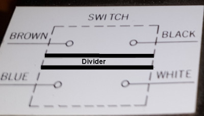

Here is the diagram from the psu.
Is there any way for me to connect the psu to the power switch without risk of frying something?
Reply 1 of 21, by derSammler
You say you have a multimeter. Connect the PSU to mains and find the two of the four wires that have main voltage. These are switched to the other two wires by the switch (order doesn't matter, since the mains wall plug is not keyed in your country anyway). How the switch works is already known.
Reply 2 of 21, by TheMobRules
Since you have a multimeter, you can first do a continuity test between the connectors and the plug on the back of the power supply. That way you can identify which of those are the live (brown) and neutral (blue) coming from the mains.
The other two wires are the ones that connect to the PCB of the power supply, with the convention being black = live and white = neutral. So you can open the PSU case and see where each of those goes.
Once you have identified those, you can connect them to the switch so that when you turn it on, "brown" is connected to "black" and "blue" is connected to "white" (i.e. live to live and neutral to neutral).
Reply 3 of 21, by Baoran
I am still bit confused. I tested continuity. So the one I thought is blue doesn't connect to any of the 3 pins at the back. The one that I thought is white connects to right pin and one of the other 2 wires connects to left pin.
So do I make the switch short between those blue and white and also short between the 2 other wires?
Also is it brown or black that is connected to the left pin in the back of the psu?

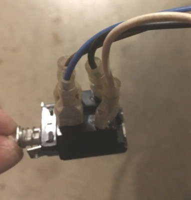

Reply 4 of 21, by TheMobRules
Baoran wrote on 2019-12-29, 18:55:
The colors are just a convention, just use this picture as a guide:
49.25 KiB
741 views
IEC plug
So, by doing some continuity tests, you can identify which of the 4 wires connects to the mains hot and neutral. Let's call these "brown" and "blue" respectively, the remaining two will be the ones to carry power back to the PSU when you press the switch (the convention is black/hot and white/neutral). So you must connect them to the switch so that when it is turned on, brown connects to black and blue to white. It should also work if you connect brown to white and blue to black since it's AC, but in some places like the US they care about hot/neutral when wiring the outlets.
In any case, identifying the wires that are connected to mains is easy, so you must take care that you don't attach them to the switch so that there's a short between them when you press the button.
Reply 5 of 21, by Baoran
Thank you for the help. The reason I asked about the colors was that I could mark the colors on the wires that I would not have this kind of trouble in the future with this psu.

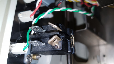

Reply 6 of 21, by Horun
this is the typical layout to switch in pics, rare that yours are all brown but have also seen all black wires too. if there is also a green wire it attaches to case or screw at the switch
Reply 7 of 21, by Baoran
Yeah. it is like there is just small ring of color below the clear plastic that is suppose to indicate which is which and that clear plastic has yellowed which makes it impossible to see which one is suppose to be brown and which one is suppose to be black.
Reply 8 of 21, by Tiido
Only multimeter action will help here and you only have to determine which of the two pins are AC input ones, connect up one probe to one of the pins on input and find the wire connecting to it on the switch end, mark it and find the other. Those two connect to the unmarked one, and it doesn't matter which way. If you have AC output on the PSU you can use it for determining the polarity.
