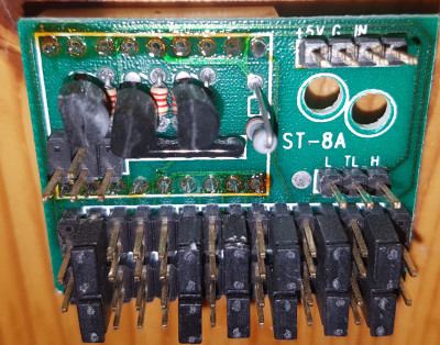

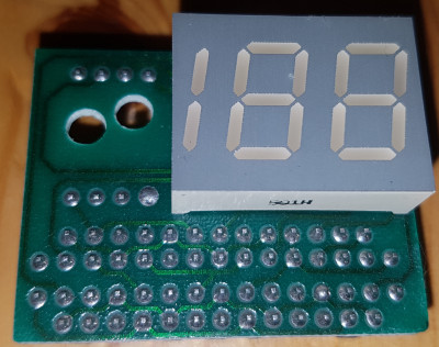

I don't have much experience with lcd display, so I was wondering if someone could tell me how I can get power to the lcd display inside the case? I just took this lcd display out of a case that I was thinking of using for new build but I am not sure how to get power to it that I could try configuring it when most power supplies only have molex and floppy power connector. Is there a cable or something I need to buy that I can get power from one of those molex connectors to this lcd display?
Also if I manage to get power to it, can I just randomly start changing jumpers to see what segments they affect or is there risk I would break the lcd?

Connecting the [ 5V and G(round ] pins in the top at the right should do the trick.
For power you can try to find one of these (or solder your own version).
https://vesard.com/525-Zoll-Molex-Adapter-mit … hluss-fuer-LEDs

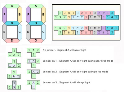

The two rows at the bottom seem currently to be jumpered for 66 continuously.
The four pins in the middle at the left are likely for the '100' digit.
Here is a layout for variations:

You can hook up the power to a 5 volt battery (or a three pack of 1,5 volt) for easier working with it.
The three pins in the middle on the right [ L - TL - H ] are for connection with a turbo switch - the original turbo switches looked like this:
