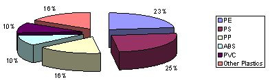

Most Children's toys are not made of ABS Plastic. The yellowing of the ABS in vintage computers is not really becasue of direct sunlight. It's becasue of the bromine content reacting to UV-A, and florescent lighting and it took 20-30 years to happen. It not really sun faded.
As you can see in the graph children's toys amount to 10% in ABS, and fact is the way ABS is made today is a lot different than back then, these days they mix carbon into the plastic to keep it from degrading. Such as ABS Black Pipe.
plastic is not plastic.
