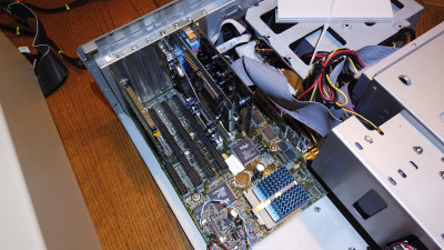

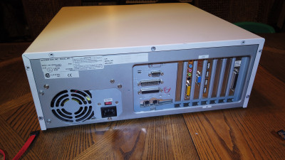

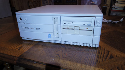

Reply 11 of 12, by joeyjojo
Here it is. No surprises inside but its still a pretty good machine. Only one problem, I have no way to add software to it 🤣. I do not own a floppy disk of either kind and there are no cdrom drivers on the system. I need a boot disk with cdrom drivers and then I can burn some cd's and install windows 95 or 98. Its rocking 3.1 now. It did come with a printer and a 6 disk cdrom changer. Never seen one of them before. Im sure it works but I don't think it will read burnt cds and the autoexec.bat and config.sys are a mess. errors on boot. I would just much rather wipe the machine and start fresh with windows 95. Anyone know where I can get a floppy with cdrom drivers ready to go? I know about the floppy drive emulator but I really don't want to spend anymore money on these retro systems at the moment. I just picked up 2 lian li cases, 7 sound cards, 5 agp video cards and today this gateway 2000 p-75 plus some other odds and ends. My wife is going to get pissed here soon lmao.
Reply 12 of 12, by kolderman
Nice. I like gateways. If you search for boot disk downloads you will find plenty. There is even a tool that will format and write a good boot disk to a floppy drive. Pity the mobo doesn't allow booting from CDROM.
