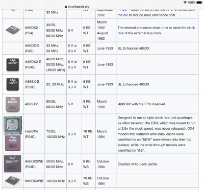

Reply 2 of 21, by Intel486dx33
Well, the posts reads the “P24D” is only for the “Intel-486dx2 CPU”
Is it also available on the 486dx4 ?
I will have to inspect my CPU for write-thru or write-back markings.

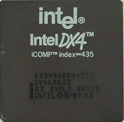

Reply 3 of 21, by BinaryDemon
The "&E" on the chip means it's Write Thru. (I was assuming that was a picture of your actual chip).
Not sure what P24D means to your motherboard, if it's simply telling it that it's a DX2 or better, or something else.

Reply 8 of 21, by mpe
Write-back is faster. There should be no difference in reliability but some motherboards doesn’t properly support WB thus it can be disabled.
If you have a WT model (like the one above) no special jumper settings are necessary as CPU pins these jumpers connect won’t do anything and yhe CPU will work in WT mode.
All DX4 use 3.45V or 3.3V. Some boards sense the voltage automatically when a DX4 is inserted.
You want settings for P24C.

Reply 9 of 21, by Intel486dx33
I am testing with a 486dx-100 ( &E ) write-through CPU right now.
I have it setup correctly except for the voltage. I know it’s a 3.3v CPU
But when I set the motherboard for 3.3v it will not boot.
I need to set the jumpers for 5v for it to boot.
At least that is what the manual reads that I have the jumpers set to.
Do you think there maybe something blown on the motherboard like a diode or resistor ?
Reply 12 of 21, by H3nrik V!
Intel486dx33 wrote on 2020-01-13, 08:39:
I am testing with a 486dx-100 ( &E ) write-through CPU right now. I have it setup correctly except for the voltage. I know it’s […]
If it's you CPU (SX900) pictured, then according to http://www.cpu-world.com/sspec/SX/SX900.html is runs on 3.45 Volt. All though I would expect it to at least POST with 3.3 ..

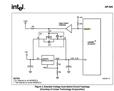

Reply 14 of 21, by mpe
Unless the board is actually sensing VOLDET pin and supplying correct voltage (no matter how you set the jumper) as per reference design by Intel.
download/file.php?mode=view&id=74445
In that case you'll measure 5V on the socket until you insert a compatible Intel 3.3V CPU.
This wouldn't explain why it doesn't work when set to 3.3V. What model of board we are talking about?

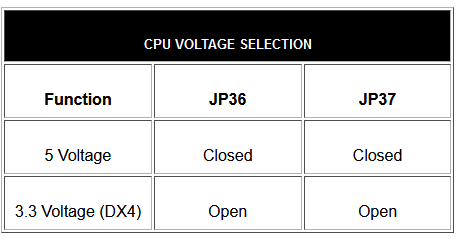

Reply 18 of 21, by CoffeeOne
Hmm, so you are talking about the gigabyte mainboard ga-486vs
6.04 KiB
178 views
So I see the problem.
So that suggests that there is really no autodetection.
But why they needed 2 jumpers for 1 bit of information?
