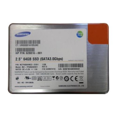

Reply 7 of 8, by cyclone3d
Nvm1 wrote on 2020-01-16, 17:58:
Sounds almost as if you have an Asus L8400 series system. They had those sound/videocard combo's. Can't say what system is best, mine is just repaired and is waiting for a cheap Pata SSD to reinstall 98se on it.
So perhaps in 2 weeks that I can help you more 😉
Why bother with a PATA SSD? Just use a PATA to SATA or even better (so it will definitely fit without having to hack the SSD case) is a PATA to M.2 adapter.
If you want to go PATA to SATA, you can as well. You just most likely need to get a SATA SSD that the case can be chopped so everything will fit.
The old Samsung PM810 drives work great for this.

Reply 8 of 8, by Nvm1
cyclone3d wrote on 2020-01-16, 18:07:
Why bother with a PATA SSD? Just use a PATA to SATA or even better (so it will definitely fit without having to hack the SSD cas […]
I do have a few pata to Msata converter, and one pata to M.2 also, but the price of the pata SSD was only €21,- euro so for the time I use them they should outlive me 😉
But since I am getting alot of leftover MSata and M.2 drives out damaged laptops I want to see if they work as hassle free and reliable too.
If you already have any experience (or others) please share them!
