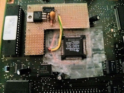

94.81 KiB
467 views
I successfully replaced a 386SX-20 with a TI486SXLC2-50-G on a IBM/PŜ1 2121 model several years ago (I used an empty EEPROM socket to plug a breadboard with the power regulator). With a 33 MHz crystal the 486SXLC2 works great at 66 MHz and the 8 kb cache makes a great difference when enabled. Only issue is the floppy drive, it doesn't read floppy disks when cache is enabled (DMA and no cache flush is a know source of issues). The chip doesn't even get hot running at 3.3v and a bit overclocked.
Reply 67 of 67, by IBMMuseum
