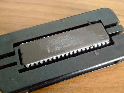

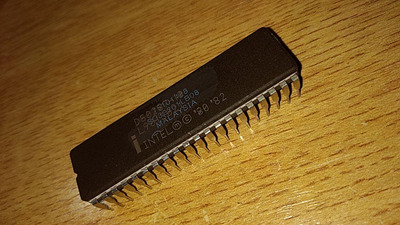

Hi,
i recently purchased 287 FPUs from Ebay..
i got this Fake..

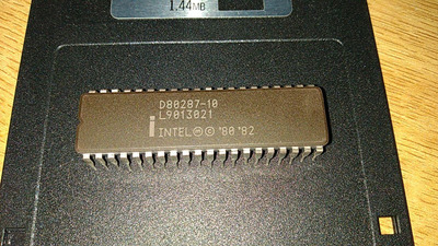

The Seller uses Original Image of 287 and sends painted Motorola ICs..
As you can see on the socket is the original FPU from Intel.
Ebayseller is huayi-components.
Thanks
Matthias

Reply 7 of 21, by matze79
Yeah already contacted, the Seller has Original FPU as Picture but sells this variant.
I don't think he is serious, otherwise he would have the right picture for the IC.

I've bought a 80287-10 from this seller almost 2 years ago. Plopped it in a 286 motherboard and the system configuration table reported "Numeric Processor: Present", didn't do more testing at the time. I guess I'll have to do it these days 😀
How did you expose the relabeling? Some solvent or just by scratching the paint.

Reply 19 of 21, by Anonymous Coward
I see a lot of those fake 287s on Taobao. Most of them seem to be 8088s. Some of them they don't even hide the old writing on the IC. I've seen ones that have both P8088 and D80287 printed on the surface.
This even even limited to intels. There are fake Cyrix 82S87 Fasmath chips out there too sold in a suspicious plastic package. Perhaps there are some legit PDIP versions of this chip, but every one I've seen is CDIP.
