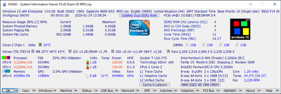

I just tried swapping the Intel Pentium D 940 (Presler) in my Gigabyte 965P-DS3 system for an Intel Pentium Extreme 840 (Smithfield) and Windows 10 x64 won't boot, but Windows 7 x64 does. Windows 10 starts out OK, but half way through the system reposts.
I have just swapped back to the 940 and now Windows 10 does boot, so it's not an issue with the installation.
Has anyone got any ideas as to why Windows 10 does not like my 840 CPU and/or to get it to boot please?

    Windows 10 x64 is OK with the 940 installed

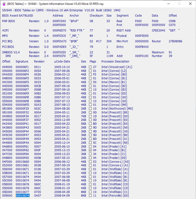

CoffeeOne wrote on 2020-01-19, 21:07:
You might need a modified - unofficial bios for that cpu. But you checked that already I guess.
I have done my best to check and as the BIOS contains the 0001067A microcode it should work OK, but given Flags is 11 it's not for LGA771 Xeon which as no big deal as Windows will load it.
file.php?id=74894
    93.36 KiB
    356 views
    CPU Microcode in the BIOS

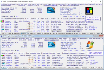

Reply 8 of 8, by red-ray
The LGA771 to LGA775 adapter just arrived and worked like a charm. I can now boot both Windows 10 and Windows 7. In both cases the µCode was loaded by Windows (it's not in the BIOS) with Windows 10 having a later revision.
The unexpected thing is the memory data rate is 833 MHz rather than 800 MHz which I think is down to P965 chipset limitations.
file.php?id=75022
    181.97 KiB
    305 views
    Intel Xeon X5450 QC (Harpertown) 3.00GHz [C0]
