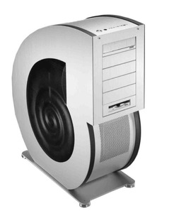

I have a really nice Lian Li Silver Aluminum full size ATX computer case from 2005.
What is the best hardware to use ?
I want it be close to 2005 period correct or just the best hardware before 2010.
It is going to be a Music/Gaming build.
I already have the sound cards picked out.
Motherboard ? ( 755 socket )
CPU ? ( core-2-extreme or core-2-quad )
RAM ? ( DDR3 ? )
Graphics cards ? ( Nvidia )
OS ( WinXP ) ?
