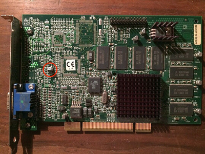

I received a Voodoo 3 3000 PCI card today.
I was told it does not work.
From a visual inspection it looks like a Capacitor was never installed so this card probably never worked from the factory.
I compared it with a photo from the internet.
Can some one tell what voltage capacitor will work in this card ?
The capacitor reads ( 10 , 16s , 904 or 9G4 )

10uF, 16V. But there's no need to install it, as it is not used.

Reply 3 of 14, by Ozzuneoj
I doubt that cap is the problem. Highly unlikely that they shipped it out with a component missing and no testing.

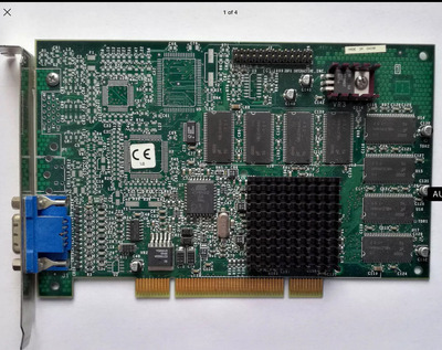

Also, that is a Voodoo 3 2000 PCI. The 3000s always have a larger silver heatsink (though, very rarely they have larger ones that are painted black too). This is a 3000 PCI with SDRAM:
http://www.3dfx.ch/gallery/v/3dfx_collectors/ … _front.jpg.html
Notice, no cap in that position either.
I would bet that either it is something very simple (contacts need cleaned) or there is damage to either a trace or to an SMD component. The chip can cook itself and die as well, so that's another possibility, though not as common. One thing I have noticed with voodoo 3 cards that are just "dead" with no clear reason, is that the tiniest bit of pressure applied to the middle of the card will create an audible cracking\creaking sound. I've never heard this sound from a working card. If I had to guess, some of the BGA solder joints have broken behind the 3dfx chip. I have a few I plan to take a hot air gun to at some point to test my theory. 😮
EDIT: Also, it is somewhat possible that the capacitors need replaced, though I have admittedly never replaced intact-looking caps on a V3 to fix one, and I have handled dozens of them in recent years. If one is broken off and it is supposed to be there, then it needs replaced. That fixes the problem 90% of the time.
Reply 4 of 14, by Intel486dx33
Yeah, It has no video output.
So I am going to add the missing capacitor and see if that fixes it.

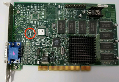

Here is another photo of the same card with-out the capacitor. So maybe it was not needed.
Reply 12 of 14, by imi
the heatsink on your card seems to be at a slight angle, maybe it got bumped hard enough to break a solder joint under the chip?
