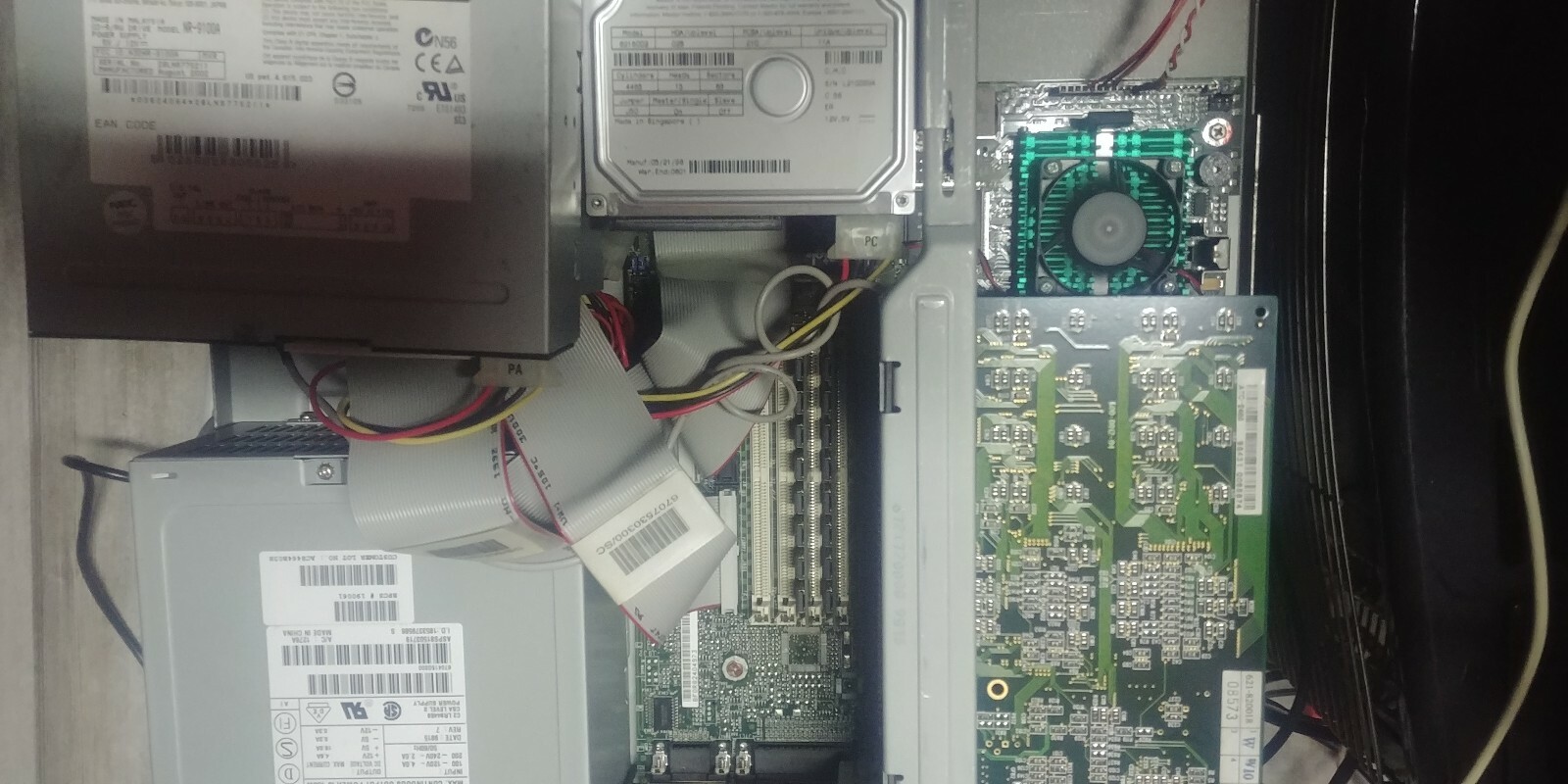

This is a real long shot but can anyone ID this sound card? it's an ISA card for sure this is the only photo i have for now.

why are you sure that it's an ISA card?
looks more like PCI to me, I don't really know of any ISA card with SMDs on the back, let alone this many, also ISA cards usually face component side up.
it also looks like a GPU and not a sound card.
e: pretty sure that's a Voodoo 1
it definitely is a Voodoo 1, see http://www.vgamuseum.info/images/palcal/3dfx/ … 1_bottom_hq.jpg

4MB 3DFX Voodoo PCI, part number 621-820018. Layout matches, as well as the large plated hole.

That is not a sound card and it is not ISA either.
The placement of the capacitors on the back give it away.
The sticker that is barely readable in the picture starts with ATC, which indicates A-Trend as the brand.
After a bit of searching, it is an A-Trend Helios 3D PCI video card (voodoo 1 4MB)
See here for pics of both sides:
http://hw-museum.cz/vga/3/a-trend-helios-3d

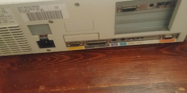

Reply 9 of 41, by darkomen
Hmmm well now I'm confused... It would of been amazing if that was a Voodoo 1 but I don't think it is as from the back the only expansion card is a sound card.
That's why i assumed it was a sound card... Confusing... The seller is selling a bunch of old PC's so maybe he got confused with the pictures but the inside layout matches the old Packard Bell perfectly...
Very strange.

Just saw, amazing if it does!! 😁 but this picture says otherwise to me sadly...

If you check the image above, it shows the sound card, not sure if you can make out much from that picture but it definitely has one. Your knowledge on this machine is incredible. I love this place!

If i remember correctly.. and I'm going back like over 20 years ago but I swear the top port was a single PCI slot then the other 3 were ISA. So it could very well be hiding there.

That's no Voodoo, that's one of those Aztech cards, in this case one without modem. If you look for the FCC-ID on the card it should tell you which it is. I'd say I38-MMSN837 but it could also be I38-SN97125 or I38-MMSN824 or some other. In any event, for DOS drivers it's the chip that's relevant. You can find all the drivers here: http://www.vogonsdrivers.com/getfile.php?file … menustate=41,36
If you have a 2316(A/R), try the Sound Galaxy Pro 16 II drivers. If it's the 2320, try the Sound Galaxy Pro16 III-3D PnP drivers. Or rather: the respective config tool. You don't actually need a TSR driver, just something to tell the card which resources to use.
And as for that knowledge - I used to work at the Packard Bell helpdesk around 2000-2001, when these things were already old, but recent enough that there was still documentation and people called in asking about it.

I realize that you are excited but why not just wait until you receive the item and pull out the card and look at. The reason why you someone though it was a voodoo is becasue you didn't show them the other pictures. Thus we have this confusion about it and it's fine becasue now we have something to talk about but I am sure that most people if they had the pictures would of known its some type of sound card. And that's not really important. Whats important is physically pulling out the card and inspecting the chips and writing on the card to determine if its good or not. And thats pretty hard to do even if we know its the back of a sound card.

the card in the first picture is still a voodoo though :p
that and the rear view show two different cards in the same system ^^

The picture from the back of the computer is a sound card but the card asked about in the other thread shows the backside of a Voodoo 1 4MB card. One sold by A-Trend to be exact.
