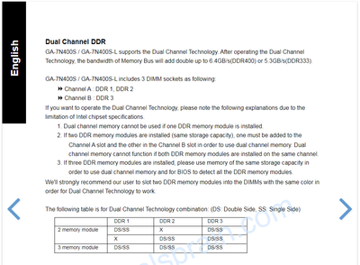

You have a dual channel board, why don't you run the memory in dual channel mode? 😁
Let me give you a hint:
GA-7N400S / GA-7N400S-L includes 3 DIMM sockets as following:
Channel A : DDR 1, DDR 2
Channel B : DDR 3
So I would use only 2 RAM modules, best when they are of the exact same type.
I understand, you have 2 512MB modules of the same type, so then:
Slot1: Module1
Slot2: Empty
Slot3: Module2
=> both channels are populated, yay.

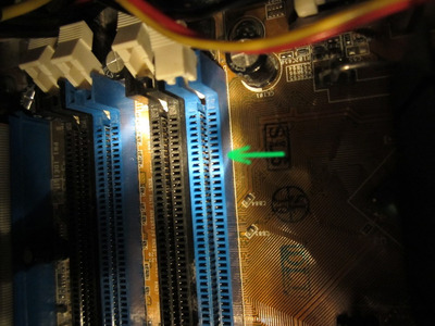

I'm sure you've been quite thorough, but I would look in the damaged slot one more time. With a flashlight, and maybe a brush. Those single fingers are small, and a broken one may still be sitting there. I had one causing random crashes here for a while before it fully gave way.
... aha, I did keep shots. Just for interest

Thanks for the advice pewpewpew, I'll look into it once again! However, I don't know how to address the issue of test #5 failing, except for getting different modules.

pentiumspeed, I installed modules according to the manual. Is it incorrect?

I'm suspicious you may have a bad slot and a bad stick. I'd be repeating the test with DRAM1 & Hynix, to see if that PASS turns to FAIL with further passes.

Second, I tested one of the 512Mb modules in slot 3 at 50% frequency, as DDR200. It passed, so I assume the slot is physically OK.

This is correct. 3rd slot is dual channel slot. Load both 1GB modules in 1 and 3 and this will be in dual channel. Many computers prefers loaded in correct order.
Since you don't have more than matched 1GB modules that is your trying to make do with 512mb and 1GB in your computer. Then end up errors as motherboard find inconsistent accesses and cause crashes.
This is user error. Get more 1GB and load 2 sticks in 1 and 3. And this will work properly this time.

Using 2 modules 1GB each, Fill the 1 or 2 with slot 3 filled (A: one module in 1 or 2, and other module in B). That will be 2GB dual channel mode in two configurations. 3GB still works as dual channel mode as manual stated. Manual also states has to be same size and matched set. Kingston 1gb is defective or is high density (8 chips). You want double sided (DS) which is 8 chips per side for total of 16 chips per module especially 1GB modules.
That's low density for double sided (DS). Important! Manual also state this as well.
