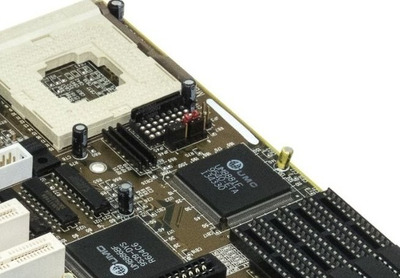

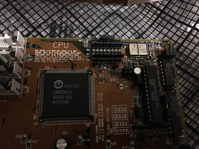

Someone on twitter has a Biostar MB-8433UUD-A Rev 2 that is missing the RN11/12//13/14/15 resistor networks/packs needed for selecting CPU type. Does anyone know the value / part number of these?
https://twitter.com/DosFox1/status/1223644423436800003
I found a few threads on here suggesting that some of you have this motherboard, so I thought I'd ask.

HunterZ wrote on 2020-02-01, 17:44:
Mystery solved? https://twitter.com/DosFox1/status/1223659709988851713
It seems they may actually be B000J jumper packs.
Thoughts on how to go about fixing this?

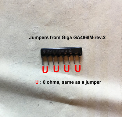

I have a different 486 board that has those "resistor" packs. Will try to get it out and take some measurements this weekend.
Reply 3 of 5, by Horun
Ok my only board with them is a Giga GA486IM rev.2. The "resistor" packs are labeled SMT BOOO G and are O ohm between pin sets. Just like the BOOO J in the links above. See pics below
Reply 4 of 5, by Horun
This is the best picture I could find of the Biostar MB-8433UUD socket area, and it appears to have BOOO J written on them.
Big Thanks for asking about this as I have wondered if those were really resistors (like SCSI Term resistors) but never looked into it.
