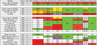

Hello there, I spent some time testing my collection of pci cards on ms-dos 7.1 with the phil's benchmark pack.
Initially I was using a P3-650 mhz with a MSI BX MASTER mb but I started to get issues with some cards, avance logic card was freezing during some benchmarks, the ET4000\w32p refused to boot (both my et4000 cards) and I noticed some screen corruption using some cards. I had to switch back to a ss7 machine, I used a K6-3+ @ 550 mhz with the Aopen X59 pro.
Every card has been tested with the maximum memory installed.

Still I had some quirks, but I suppose it was because of the cards, the purple color on there shows that the benchmark was able to run but with issues.
Sis 6202 had troubles running benchmarks at 640 with 2mb of memory, banding and screen corruption, it doesn't happen when 1mb is installed and try different chips didn't change the result.
I did a topic before about matrox cards but then deleted since noone was interested, it seems the one with older bioses has less compatibility issue on msdos, the Mystique with bios version 1.2 gives a bit higher results and works on Chris 3D 640, while it doesn't if updated to bios version 1.8, unlucky I haven't been able to find any other bios release.
Trident 3DImàge 9750 other than the bad performance it has screen corruption on PC Player 640 on the higher and lower border.
On the other hands I have been impressed with Permedia 2 performances, despite being an opengl\winnt card it was very good on dos. The ET6000 is great too.
I was wondering if anyone know the difference between ET6000 and ET6100.

What’s the un-colored (white) boxes represent? I’ll have to take a closer look at Permedia2.

Uncolored because I'd have to use too many colors
Green is for the best performance, yellow second, orange third and red the worst.
The last 2 3dfx cards have white color because I wanted to try the Nvidia GeForceFX 5500 pci too but it wasn't boot on ss7 machine so I took it off from the comparison.
I also did the quake 640 benchmark (with vbe 2.0 cards only since it didn't work with 1.2) but the results were cpu limited so I took that off too.

Nice ! Thank you. When you say Maximum memory did the Matrox cards have 8Mb or more ? I have some M2 with 8Mb but never tried Chris 3d test on them, odd to see good results on one test but black screen results other test. Maybe the card/matrox driver doesn't like the way the higher end test initiated.
Other thing: never thought a CL card would perform as good as your results on the 5446. Very interesting !

Thank you for showing some interest 😀
I uploaded the version with mb memory for every card, I should say that for maximum amount I mainly refer to older cards with SOJ package.
About the matrox cards, I would be curious to check the other bios release or other release for the m220 or millennium 2 but I can't find them, they have a great quality output and if downgrade the bios (I found how to do it since I was able to downgrade from 1.8 to 1.2) improve the dos compatibility it would be the jack of all trades, believe me when I say that some of these cards have a very low quality, it can be seen on Chris 3D 320.
I agree with you the CL-GD5446, has good results, too bad I don't have the GD5440, it was the chip after the 5436, I found it for 20 eur, quite too much for my tastes. Another card I would be curious to test is the Ark2000mt, to my knowledge it could gives very nice results.
I did those test to decide which videocard to use on my amd 5x86, I will probably re-run the tests on that older machine but preliminary results shows it is mainly cpu limited.

Great job, man! Very interesting results, but mostly, a great round-up of cards. I've been trying to get my hands on an ET4000 and ET6000 for years but they're always so flippin expensive. The other really interesting number I saw was for the Avance Logic ALG2302.A. It is so much faster than the ALG2301.B. In my tests, the 2301.B is just a little bit faster than the GD5430, but your ALG2302.A is in the top third of your results. Any idea what brand and model the card with that chip is? Mine is a Hercules Stingray.
Some other observations on your results:
-I'm surprised at the relatively big difference between the Banshee and V3 2000 in certain benchmarks
-most of the cards I have line up with your results.
-you need to get a TNT2 M64 PCI. They are relatively cheap and easy to find and are always at or near the top of such comparisons.
-I wish you had the Ark Logic 1000/2000PV. I'd love to see how they compare to the ET6000 and Banshee. See, I have the Ark1000/2000 but not the ET4000/6000. We should trade for benchmarking purposes, then trade back when done. 😀
-it's interesting to see these results on a K6-3+ 550. I think it's actually a really good platform to test DOS PCI graphics cards. I would suggest you retest on a slower platform (P233MMX) to see how the results change. I have found that the faster the platform, the more exaggerated some of the differences between the cards become. Think about what the typical DOS retro PC would be built on today for gaming. Too fast becomes problematic for a lot of games, so the typical recommendation for a fast DOS gaming PC is somewhere between P200 and K6-2 550. I've been testing between P75 and P200 over the years and occasionally posting results here.
-you might want to test with Univbe as well. I have found that even at VGA 320x200, it slightly helps performance in certain benchmarks: Chris' 3D, Quake, Duke3D, and even occasionally 3dbench. So here's the scoop: For the S3 cards, there's S3VBE20.EXE, which only uses ~6kb but doesn't help as much as SDD/Univbe. Sci Tech Display Doctor 5.3a is what I use. It has a smaller footprint (~13kb) than Univbe 6.7 (~17kb) and equal performance. I test with and without SDD53a. It doesn't work with newer cards that already have VBE2+, like the Millennium II, Voodoo3, and TNT2 M64. But they don't need it because they already have native support.
Thanks for sharing these results. I'm always interested in DOS graphics card benchmarks. Cheers!

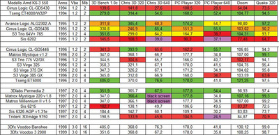

I did the same tests with the Amd 5x86 133 paired with Biostar MB-8433UUD-A, 256kb cache and 32mb FPM memory, settings for cache an memory are the fastest possible.

Results are just silly, the videocards are heavily cpu limited.
For this reason I also tried the ET6000 with overclocked cpu and bus (40x4) 160 mhz, the improvment is huge.
In the end with such pci vga cards doesn't really matter which one you are going to use.

Why don’t add a column to your spread sheet for total score of all the benchmarks to which card has the best overall score.
Thank you for the advice.
Honestly I do not think it would be useful, I just compared the overall results of the Millennium 2 and Trident card, the first get an overall higher total results but despite of that in 1 test it gives black screen, that means it is less compatible than trident card.

Shit, that SiS 6326 is an absolute dog..
I will be doing a similar test on my current Socket 7 PC at some point. I have a crap ton of PCI cards to test with it.

Sis 6326 is bad with the 486 pc, but with the k6-3 wasn't that bad (not great, not terrible), still I don't get why some cards gets lower results despite being more powerful with the 486, I will probably test the cards with another 486 mb...
