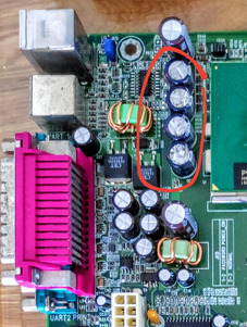

There are 4 capacitors near the CPU socket, 1500uF ones. They look ok but the tops have some thing grey marks on them, compared to all the others. Not bulging, no leaks top or bottom (can see under).
Is it worth changing these?

Reply 15 of 29, by bofh.fromhell
RBretrox wrote on 2020-02-04, 17:18:
Some good advice on more items to check. Thank you for the help so far. […]
If you are comfortable doing it and you think the MB is worth it.
They are probably OK tho.
But I'd check for shorts, especially in and around the rear connectors and in (and under) the expansion sockets.
Or missplaced/missing jumpers.
And if work previously have been done on this MB check for flux residue and/or bad solderjoints.
A thorough clean of the entire board might also be a good idea (dish soap and warm water and dry in the oven at 50C or so then soak the BGA chips in IPA to remove any stubborn water).
You have tried the MB outside a case?

Are the CET items in the photo attached the VRMs?
1.37 MiB
278 views
I think these smelled a bit at the time, but don't appear to be burned out.
Is this something that could be swapped for replacements? Are they very specific parts or are there generic replacements? I'll do a search now.
