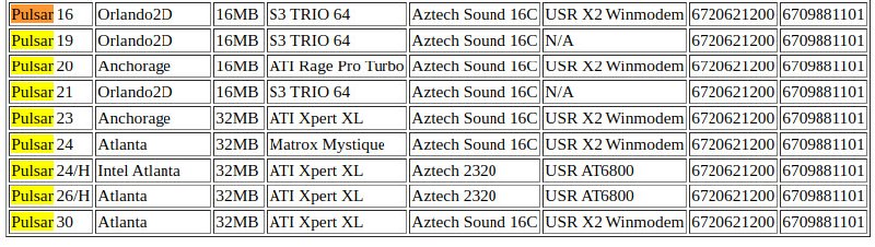

I'm looking into the best options for my Packard Bell Pulsar desktop. I plan to run Windows 95 and MS DOS on this machine. Looking at the specs for these models mine is a Pulsar 23 model onwards.
Will the Aztech 16C / 2320 sound card work well in DOS? It's definitely ISA but will i run into issues? Is it work getting another card? I'm not worried about actual sound quality or MIDI quality i just want it to work.
I also want to put a PCI graphics card into this machine because when i was a kid and had this machine (the PB Pulsar 19 model to be exact) I wanted one so badly. Now it's irrelevant obviously but I'm just really curious how it would have performed if i actually managed to get one back then. I know it's useless for DOS which is mainly what this will be used for but to cure my curiosity would be nice. I did notice the later models which my new one is has a ATI Xpert XL or Matrox Mystique GPU onboard instead of the S3 Trio my original had but I'm sure this is just as useless as mine back then??
I would love a 4MB 3DFX card or something but they are stupid money over here so any other ideas welcome as I'm really not sure what would be period correct and work well in this system without the 233Mhz P1 bottle necking the card.

I'm guessing the ATI Xpert XL or Matrox Mystique GPU's are rubbish right? as that's the models which come in the later models of the Pulsar which i am assuming mine is as its got 32MB RAM and the faster 233Mhz CPU.
Reply 6 of 16, by darkomen
Thank you for the link. Doing a bit of research on the Xpert XL, it looks like it's just an onboard ATI 3D Rage variant of some kind. Am i right in thinking this?
If this is the case and it has around 4MB ram this might actually already be what i would have upgrade to at the time back in the day I had the Pulsar 19 which had the 2D only S3 64. Is the Xpert XL just a 2D card or is it 3D capable? Sorry for all the questions I'm just really trying to do this the right way.

yes, the Xpert XL should be a Rage Pro, it is OK in 3D, nothing fancy though: http://vintage3d.org/rage3.php

I'm not sure why you think the S3 and Matrox are useless. They are quite good options and there's really no need to upgrade either, other than for fun and curiosity. Especially considering the emphasis you're placing on DOS gaming. Both are considered very good at DOS gaming, though the Mystique may have a few compatibility issues that the S3 does not.
The Voodoo will be a great compliment to the S3. Also, if you only have one PCI slot, you'll have no choice but to use the integrated S3 if you get a Voodoo.
edit: regarding the Aztech, it should work fine in DOS. My Packard Bell Multimedia C110 came with an Aztech sound card with a Yamaha chipset and it sounded great. Finding DOS drivers and getting them set up was a little tricky, but here's my thread from 2015 where gdjacobs sent me drivers and helped me get it going. Keep in mind this sound card does have some limitations (no MIDI header for one) so it may get you going now, but at some point you may decide you need to upgrade it.
