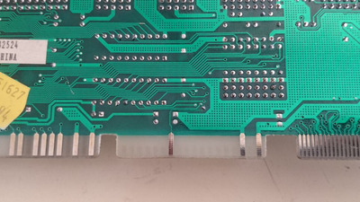

Reply 6 of 14, by coldfiremc
It's getting REALLY tricky. The IRQ 15 line isn't even connected! that's the why it doesn't respond to driver when is put as secondary. Also has a nasty capacitor in the other side!

Reply 7 of 14, by coldfiremc
update: the interrupt comes almost directly from ide cable. Therefore, is perfectly feasible a "jumper" to enable the other line. The problem is the finger is not there. it would be need to place a finger and then cut it to detour to a jumper board. No "nondestructive" mod is possible.

It's not XTIDE bios fault. I tested with a SB16 as a secondary ide controller, properly configured, and XTIDE bios can make it work very well, even with hardisks, in Protected Mode
The VLB card, despite the fact it has a jumper to switch to second IDE controller, It fails to be secondary because it hasn't the corresponding IRQ line so windows can't detect the disk properly (it works, but has strange lags and also just works in real mode).
I noticed also a strange behavior when the VLB card has 2 hardisks. The secondary lags a lot.
I formatted all things in LBA mode, so going back to CHS is not a good option. Also, the 2 previous points clearly expose that is a hardware problem.
The other cards I had are 2 holtek based. The problem is that neither has a jumper to select if its secondary or primary. Also neither has the IRQ15 finger, so physically they can't be secondary. The driver isn't prepared to share interrupts also, so there's no much I can do.
