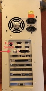

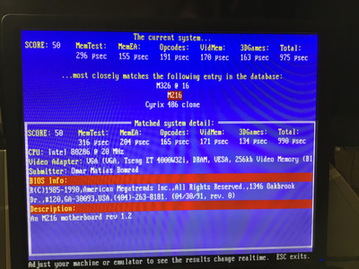

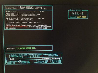

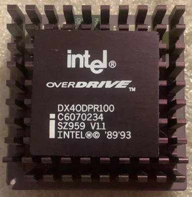

I would like to know what is the lowest speed to run a computer at to play DOS games ?
I considering wether or not to build a 286 or 386 computer ?
But I ask do I need one ?
My current 486dx4-100 computer can be down clocked to a 286@20mhz. Using the “turbo” switch and “Setmul” utility.
Do I need to go any slower ?
Some old DOS games are CPU speed critical.
My 486 can run games intended for an IBM 5150 just fine.
