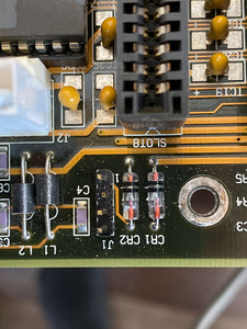

I tried to measure the current both when turned on and off and didn't detect anything with my multimeter. I'm attaching a photo of the header, next to it are two diodes (I'm guessing) connected in series to the 3.6v pin. Maybe one of you can deduce something from it?
Also, noticed the rechargeable batteries are not getting warm when the computer is running. Does it mean they're not charging, typically they would feel warm when plugged to a regular wall charger.

Reply 6 of 6, by Horun
Ok, CR2 definately makes sure the battery is connected properly or else no volts to cmos, also would prevent any charging. You need a 4.5v +/- battery source (4.5v- 0.7v for diode=3.8v) so three AAA or AA batteries is what it needs. It probably had something like the attached picture originally which are near impossible to find.
