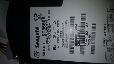

I have a seagate hard drive that is 545Mb. I was wondering if there would be any chance to use it in a system that has the 528Mb size limit. Like would it work if you set it in bios to have 1024 cylinders instead of the actual 1057 cylinders that the hard drive has or would that cause problems?

It works as long as none of the CHS values are set higher than what the drive reports. So you can use 1024 cylinders instead of 1057, but you can't set e.g. 3 heads to compensate less cylinders (or sectors) if the hard drive reports only 2 heads. This is important because the max. drive size of 528 MB translates to CHS 1024/16/63, which may use higher values than your 545 MB drive for heads and/or sectors.
Reply 3 of 9, by Baoran
Well, the limit in bios is 1024 cylinders, 16 heads and 63 sectors when the hard drive actually has 1057 cylinders, 16 heads and 63 sectors, so the cylinder value is the only one I would need to change.

Would anyone happen to know what year this hard drive is from?

Reply 5 of 9, by derSammler
Baoran wrote on 2020-02-16, 18:52:
No issues to expect then.
1995.

Reply 8 of 9, by Baoran
douglar wrote on 2020-02-16, 21:28:

jmarsh wrote on 2020-02-16, 21:43:
Using 1024 is not recommended due to bugs in MSDOS, use 1023 instead.
Thank you all for your help. I was thinking of getting a pc that is confirmed that it doesn't accept larger values than 1024 cylinders in bios, but hard drive has been removed from it and this is the smallest hard drive I have currently that is not in use, so the main thing was that I was worried about was that if the disk geometry is wrong in the bios it would mess up the hard drive in some way when trying to format and use it.
