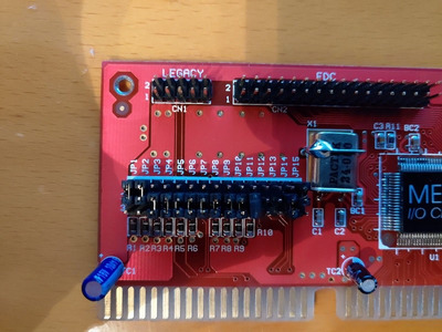

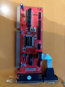

Hi, i have a problem with this i/o card i don't understand.

No matter what jumper settings i choose everything seems to be as if i jumpered 1-2.
I tested a bit around and i will take jumper 4 (LPT enable/disable) as an example:
1-2 is enable, and even when jumpered to 2-3 it is still on. Pin 2 is connected to the chip and pin 3 connects to ground via that 10k resistor.
When using a direct connection to ground (jumper cable) without a resistor the lpt turns off.
Am i missing something? Why it is notr working as intended?

Reply 1 of 6, by SirNickity
Are you sure? That's not generally how it works. E.g., the chip's pin (2) will usually be pulled up to +5V or down to Gnd to provide a default state just in case the jumper is missing or ineffective, and then Pin 1 will be +5 and Pin 3 will be Gnd (for example). If you set the state of pin 2 THROUGH a resistor to Gnd, then either pin 2 has to have a very weak pullup to +5v (100K? 500K?) or it's floating -- which is just bad design.
It's also possible that, for example, pin 1 is the chip's IO pin, pin 2 is tied to ground via resistor, pin 1 and 2 are connected, and pin 3 is tied to +5V. That way, if the jumper is in 1-2 position, it's not really doing anything -- just shorting the link that already exists on the PCB anyway. But, if you move the jumper to 2-3, you're over-riding the R to Gnd with +5V, and since 1-2 are connected, that sets the voltage on Pin 1 as well.
Reply 2 of 6, by McBierle
Ok i had time to poke around.
1.
JP1-6 and 8-11 have no connection on pin 1; and are connected to gnd via 10k resistors.
They only have an effect when i put them directly to gnd (1k also works).
2.
JP7 and 12-15 are IRQ jumpers (LPT/COM) and go to the chip and irq-buslanes, without resistors.
3.
Jumpers for:
- COM A/B enable/disable
- COM adress
- LPT enable/disbale
- LPT Bidirectional/Output
are going to the controller chip and further to this "HM8388P" dip20.
4. Jumper 6 "LPT Port"
pin 1 : not connected
pin3 : resistor -> gnd
pin2: controller chip -> cap (c4) -> gameport -> gnd
5. Strange gameport, what are 10pin gameports doing on PCs.
6. HMC HM8388P
I couldn't find a datasheet.
Pins:
1 : 12v
2-7: COM/LPT as descibed in 3.
8-9: NC
10: gnd
11-13: NC
14-19: COM-Ports
20: -12V
Measurements:
2-7: 5V... or when i pull them directly to ground (not going through the 10k resistors) change to 0V.
14-19: changing between -12/+12V depending on enabled/disabled COM-ports.
Some more things:
I got curious and pulled out the diodes through which the +-12V are going.
- The -12V side goes dark
- The +12V side gets from pin 2-7 5V.
So it seems the 5V for the defined state is originating at the controller chip.
Anyways what could be defective so that the jumpers have no effect. I mean it can't be a design mistake, or could it be that the wanted to put in 1k resistor and mistakenly got 10k ones?
Greetings and good night!
Reply 3 of 6, by McBierle
Come on, i'm in the magical Halls of Wisdom and no one has an idea?
Well i found some 1k smd resistors on a dead board and successfully relocated one to the controller...
Greetings!
but whyyyyyyyyy??????
Reply 4 of 6, by SirNickity
Tough to say. Is pin 1 actually n/c, or is there a burnt/broken/corroded trace somewhere? What's the controller chip? (You say it's in parallel with the HM chip on that block of jumpers.) Is there maybe a problem with the on-chip pull-up, where it's providing a stronger pull-up than it's supposed to? Maybe the 10K Rs were replaced by somebody? Maybe it's just a piece of junk card. 😉
