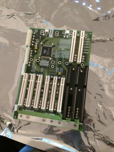

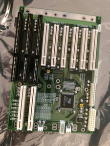

I got a Advantech PCA-6108P6 Rev.B1 passive back plane with both isa and pci slots.
The thing is that I don't have a free case, so what sort of case I should get for this.
Don't know if this will fit a standard ATX case, or if it will fit some smaller standard.
It is 26cm long, and 18cm tall.
I was thinking of something small and modern with at least space for 1x floppy, 1xZip drive and a cd-rom.

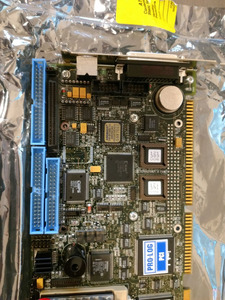

First I have is a 486/5x86 sbc card with a ST 486DX4/100.
As I already have an Ibm with an Intel 486DX4-100 in it , it sort of would be pointless to have 2 similar systems.
There is a connector on it, that looks like one half of an AT connector. Is there a way to get a converter, or else I would need to use 2 power supplies.
So currently not working for that reason.

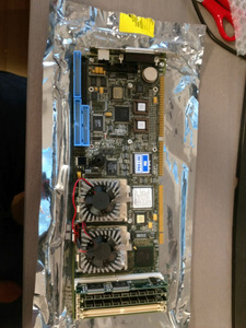

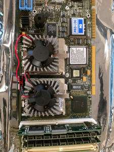

My recent requirement is a PIP10A, and is a dual cpu Pentium 1 board.
It came standard with 2x133MHz cpus, but I just got 2x200MHz cpus that are non MMX versions installed on it.
This is a socket 5 board, so no MMX version support sadly.

Check the number of slots. ATX has 7 openings, this board has 8. Generally these things fit AT cases better. You can always use an ATX PSU if you need 3.3V lines.

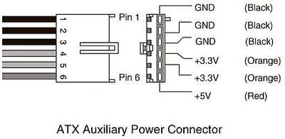

That 'half an AT connector' is an AUX connector, used in some workstation/server grade AT systems for 3.3V. Generally the systems were quite happy to boot up without it. Have you actually tried this and failed? If not, worth a try.

If it's real So5 you have another problem: no BF1 multiplier pin, so you can only set 1.5x or 2x multiplier, not 2.5x or the 3x needed for 3x66=200MHz. This is quite easy to hand-mod, connect the BF1 pin to GND (VSS) and you're done.

Pictures of that dual board? Pretty please 😀

Ok, I just got an Advantech PCI/ISA backplane that I was planning on using for a 486 SBC build. Already have a different backplane by a different company and a case that it fits in but the SBC was only showing 3 of the 4 PCI slots in the BIOS.
I think it may actually be because the onboard Tseng ET4000 W32/p video is using up one of the PCI addresses.
Upon trying to swap out the backplane with the Advantech one, I found that the 14-slot Advantech backplanes have about 1/4" or so extra PCB material on the one edge that prevents them from fitting in a standard rack mount backplane case. This is with a 14-slot backplane (take up 15 slot spaces though). So if using a full size Advantech backplane, you will want to look up the cases they made that support the specific backplane.
Yours looks like it might just fit in a standard-ish ATX case though as it is only a 9-slot with one slot being shared between PCI/ISA. Just have to make sure the mounting holes line up.
You need a power supply with the 3rd connector. Pretty sure that the wiring s not the same as a regular AT power supply on the 3rd connector from looking at the one I have here in front of me.

It's just the regular P10 'AUX' 3.3V connector I already mentioned.
18.99 KiB
340 views
(here referred to as "ATX" AUX, but seen on a lot of AT boards too)

On another note, I just got one of those dual socket 5 SBCs as well. Haven't
had a chance to mess with it yet though. Shouldn't overdrive MMX CPUs be able to
work with it?
There is the trouble of finding an AT case localy as I haven't seen many for sale.
Small case would also be an advantage, as I have too many other computers.
I didn't actually think of it, but it has 9 slots. 2 are however very close, so doubt both can be used at the same time.
Even if it is technically possible.
I would probably use pure dos on this machine. as I can't remember what sort of graphics card is built in.
I have, did not work.
Remember making it work with 2 supplies, but it was some time ago, so details are fuzzy.
It is supported, even say so in the manual.
I have booted into bios, just to check if it worked.

Sorry for not answering earlier.
Have been a bit sick the last few days.
Took a few pictures, but they only are of the PIP10A and the back plane.
