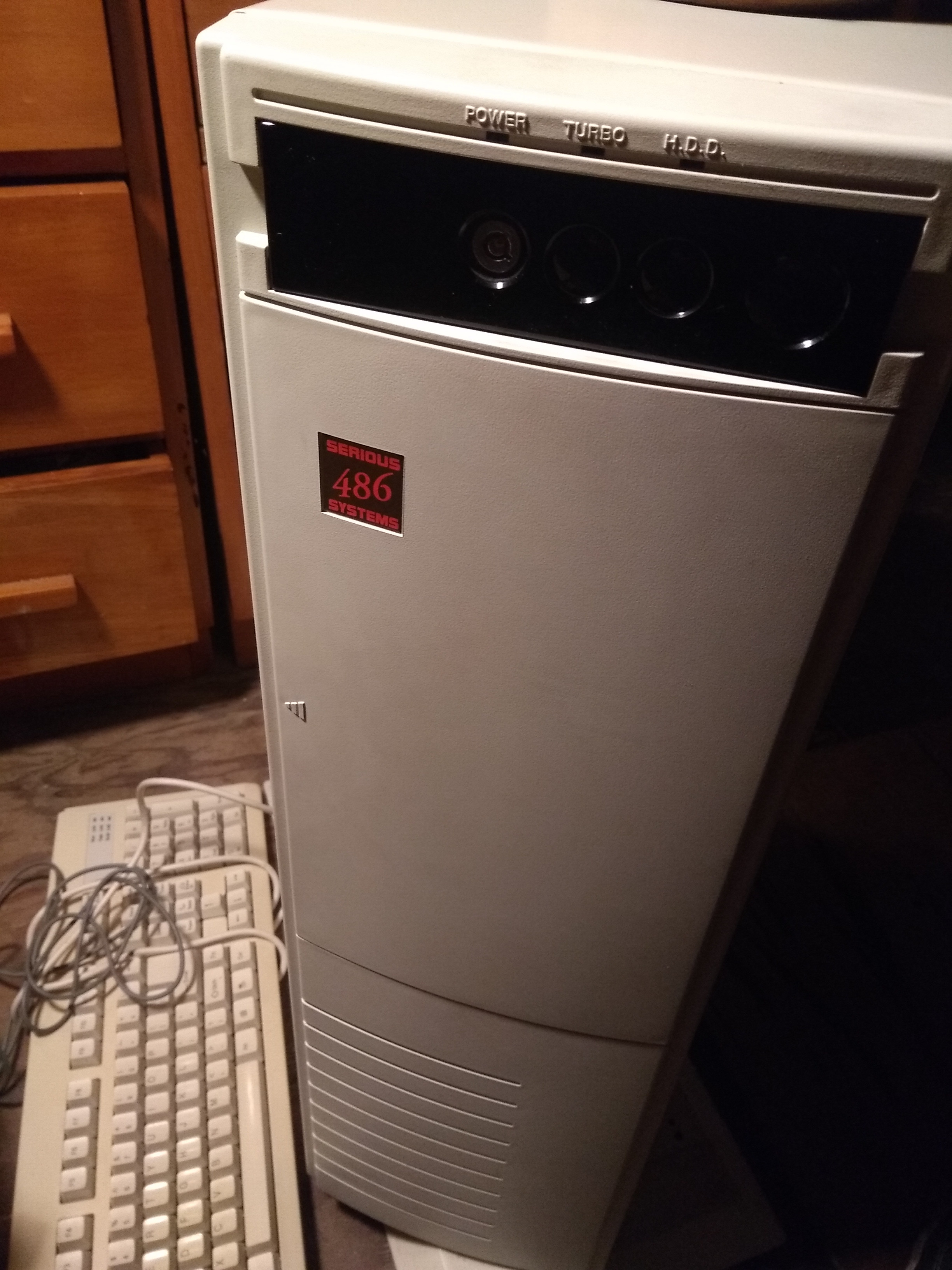

This one came to me after I got a hankering to build an old system to relive some old games. Nothing was available on Trademe, and anything on ebay was insanely expensive with freight. So, I emailed every e-waste or recycling outfit in the country asking if they had anything that would fit the bill, or at least some parts I could build something out of. Of the 30ish places I emailed, only one dude came back to me saying he had what he suspected was an unused 486 machine. He sent me a few pictures, I liked it, $200 later it arrived at my door.

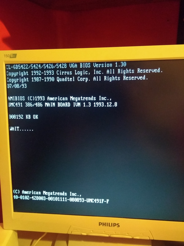

Let's see if it works
Seems that it works. I've chucked in a CF adapter to make sure it'll co-operate.

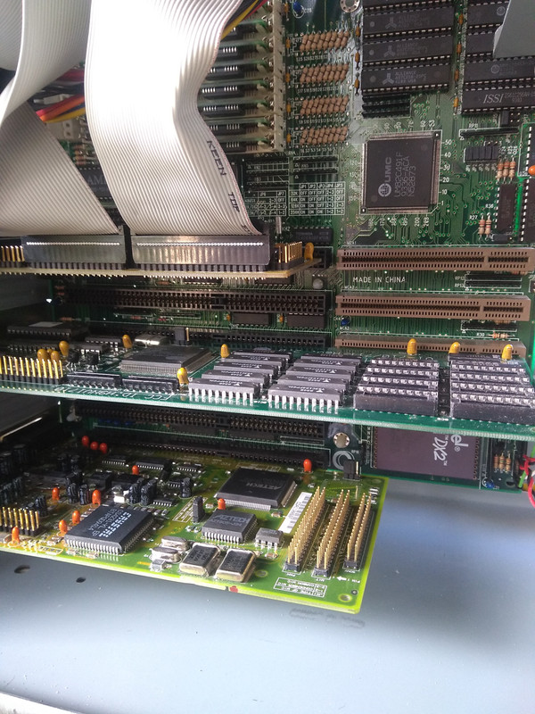

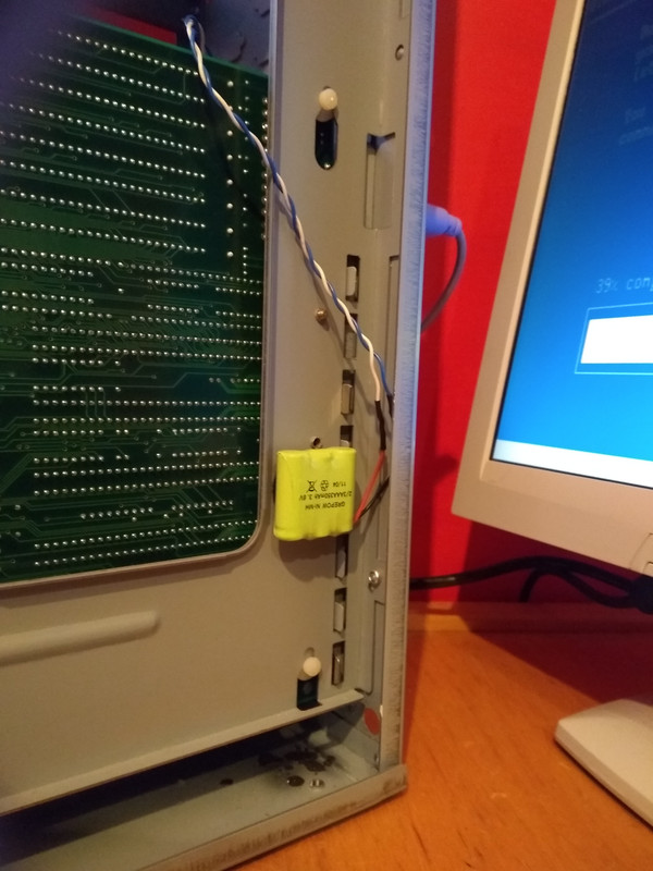

The guy at the recycling place had put it aside a year or so ago because it was too nice to bin. He also helpfully cut the battery out. It hadn't leaked yet, but he thought it best to get it out of there and replace it with this

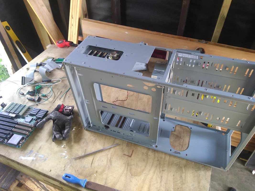

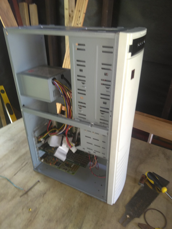

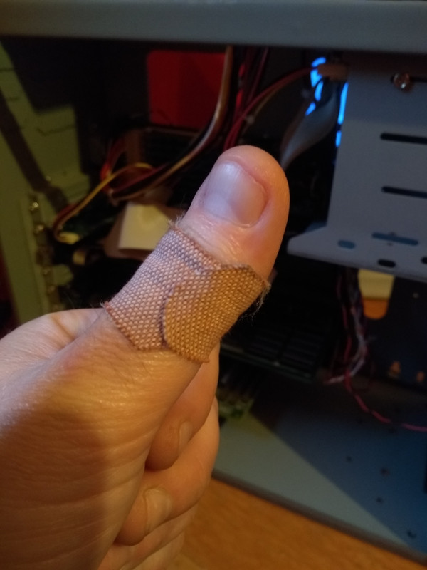

It was about this time that I got my first hit of AT case rash. This something I remember without fondness, that special time in history where case manufacturers would go out of their way to leave a razor sharp burr on every edge. This won't do.
Let's strip it down.
Neat!
de-bur all the things! I attacked every edge with a series of files to make harmless rounded edged.

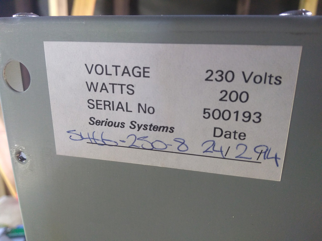

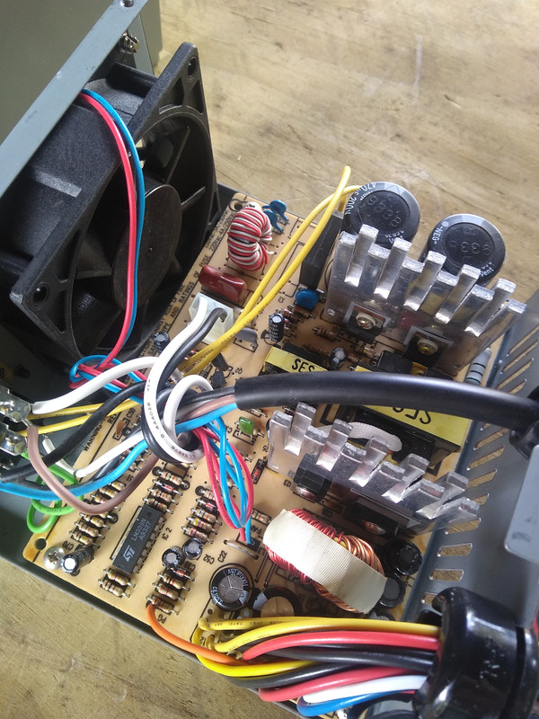

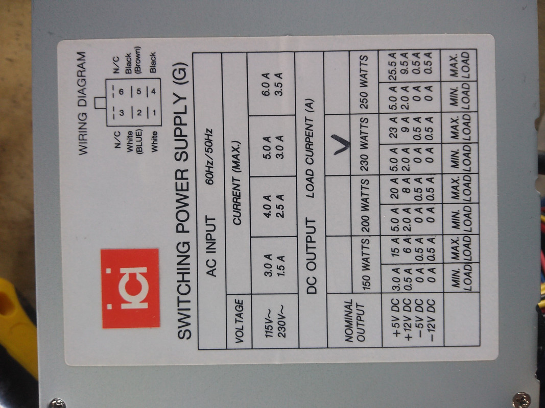

PSU check. Seems quite a beefy one for an AT
Nice and clean

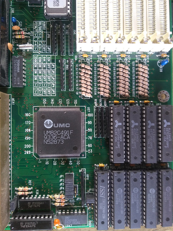

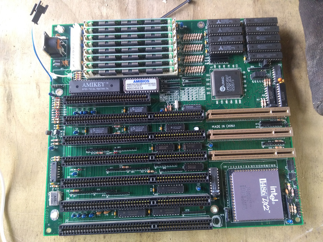

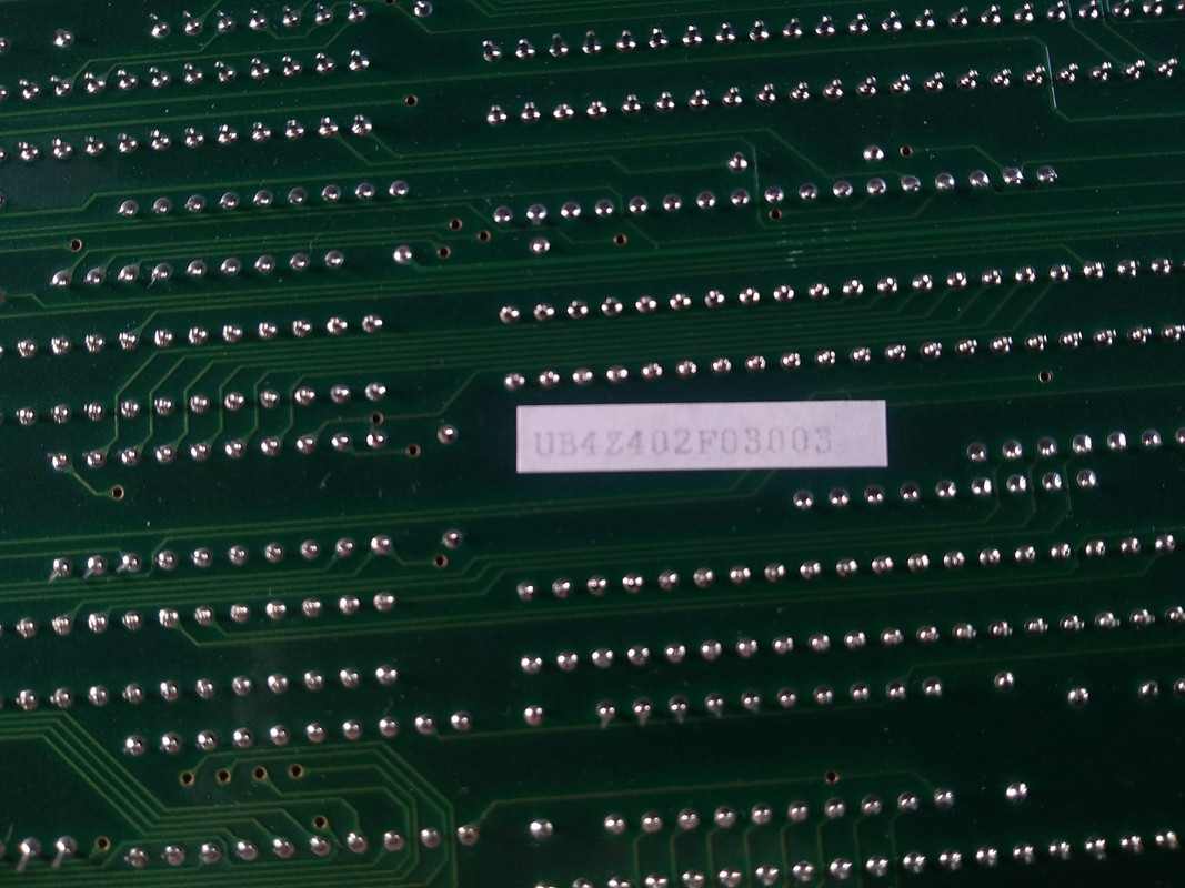

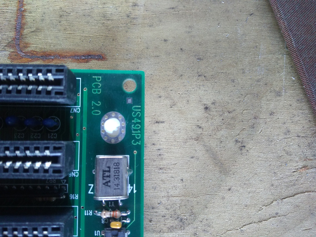

The board seems like a cheaper thing, but I'm not sure what it is exactly. Maybe you guys have a better idea

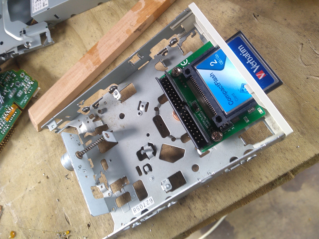

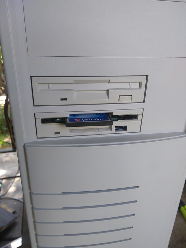

Now, we've all seen IDE to CF card adapters used in these things. What's always seemed a little dumb is having to go behind the machine, or open it up to swap the cards out. I'm not crawling around under my desk fiddling around with cards. The solution was to gut a busted floppy drive and mount the CF adapter in that. Using only a big pair of pliers and a drill, I made this. It's a bit rough, but it'll do

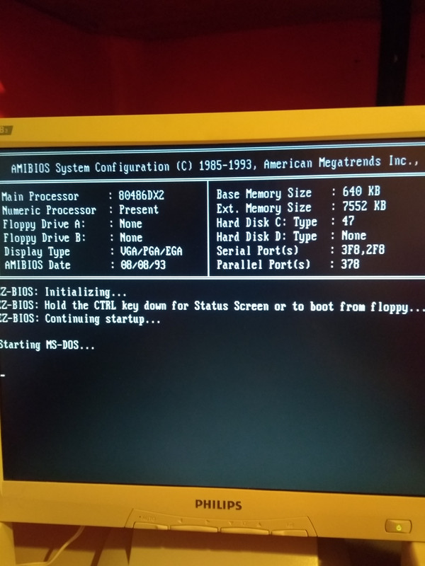

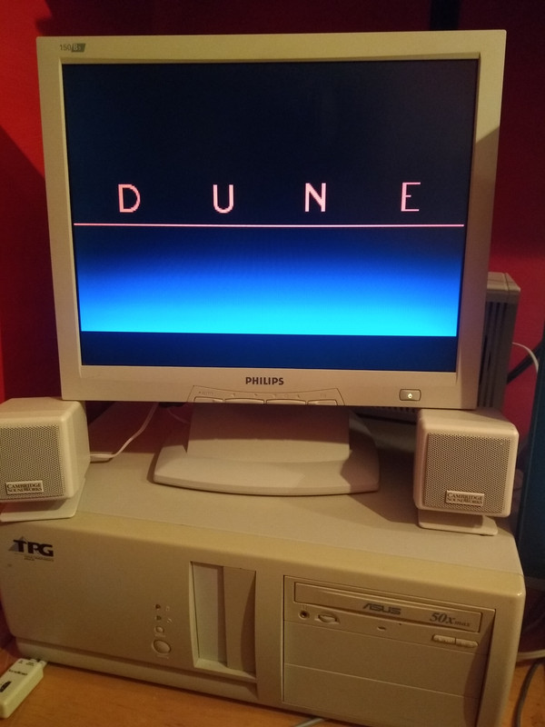

Power it up
We have RAM
We have disks
We have Dune!
Mission accomplished!

I just had the pleasure of working on one of the best cases (P4, early 2000s) in which everything was deburred and edges rounded.
There will be a Youtube video soon. For now, yes , I recall the mid 90s and razor sharp, cheap, shit ass cases: Look at them with enough intent, and your fingers start to bleed on their own.

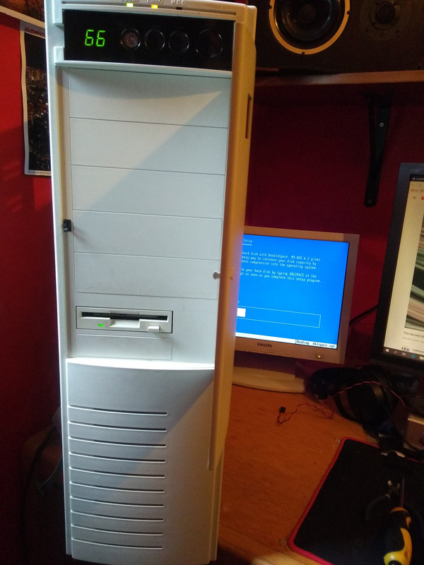

Great work ! Looks good but not sure I would have used such a tall case for a Mini board. Most of my old games I bought over the years and kept them, those that came on floppy I imaged to cd disks cause they don't fail as quick. There used to be some great abandonware/shareware web sites but have not checked lately to see if they are still up.

Didn't have much of a choice. The case and board and everything all came together as it was build when new.
Reply 4 of 17, by Robin4
Your motherboard seems to be a QDI US491P3..
Source: http://www.vcfed.org/forum/showthread.php?291 … 7-Problem-with-QDI-US491P3-mainboard-dead
https://stason.org/TULARC/pc/motherboards/Q/Q … 6-US486-P3.html

Awesome semi-restoration project!

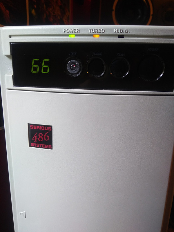

That big tower case looks so good, and that "Serious 486 Systems" is literally the Cherry on top! Thanks for sharing 😀
The Blood God demands sacrifices!

I really like that case. Those are awesomme and have tons of room for drives and drives and even more drives.
At a computer store I worked at circa 2000, it was known as "Asian death metal".
Deczor wrote on 2020-02-23, 01:51:
486 boards have a special quality about them. They're a little cleaner than earlier generations, having integrated the core functionality into a couple ASICs, but still have that exciting early-PC build-it-yourself feel to them. It reminds me of all the excitement of saving up, buying parts, then finally having everything you need to take them from their boxes and assemble a working PC!

Floppy drive for the CF to IDE, why didn't I think of that! It's been a massive hold up on my current build as I didn't want the thing round the back.
Top work!
Thanks! I'm going to start making front mounted readers that are a lot cleaner than this, which was just a bodge job with what I had lying around.
I think one if these trimmed a bit, then mounted to a bay cover with a very cleanly cut slot of the card and a panel mount LED.
I know something similar exists, but they're stupid expensive and hard to find.
https://www.addonics.com/products/adidecf.php
