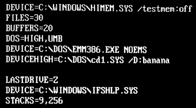

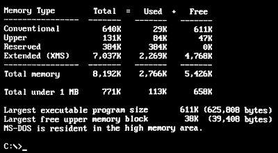

Just managed to haul my ass out of bed to crawl down to the computer for a quick photo shoot. This is the information I've managed to glean for the motherboard, DOS and Duke Nukem.
Result from DOS Mem command:

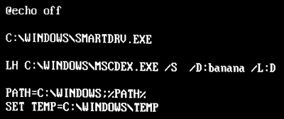

Autoexec.bat (https://pastebin.com/MnXDkT0v):
127.14 KiB
254 views
Config.sys (https://pastebin.com/2yWLzenV):
224.12 KiB
254 views

Reply 7 of 15, by GigAHerZ
Remove the smartdrv line (Or put REM in front to comment it out) and try then. This is probably the one consuming 2MB of XMS.
While you do want smartdrv in general, then being that tight on RAM, for duke3d, you have a choice of having low speed access to HDD or not being able to run duke3d at all...
Reply 8 of 15, by cookertron
GigAHerZ wrote on 2020-02-25, 10:52:
I'll give that a go thank you.

Reply 11 of 15, by kixs
You can leave smartdrv, just limit it's memory use. Caching HDD it's wise to do.
lh c:\windows\smartdrv 128
This will use 128KB of extended memory.
