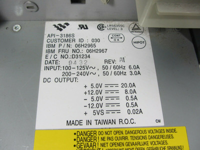

help me with pinout of this AT PSU
First post, by AlessandroB
I have an IBM Pentium 60 with a broken power supply. It was connected to 220v set as 110V and it literally exploded. Hoping that he didn't bring the motherboard with him, I would like to be able to test the computer with a standard AT power supply. These are the photos of the broken power supply, comparing the colors of the wires with a standard atx power supply, do you think I can connect it to the motherboard?

Reply 2 of 20, by TheMobRules
That's not ATX, that's standard AT (P1 + P2 connectors) + 5V standby for soft-off. You will need an ATX to AT adapter, but also a way of getting the +5vSB (purple) and PS-ON (green/black) ATX lines connected to the motherboard. Based on your picture, I would assume the yellow and black cables are used for the +5vSB that comes from the PSU (this would be the purple/black wires in ATX units). The 3-pin connector with red, white and black cables probably goes to the power switch?
I'm sure it's possible to rig something up and get it to work with an ATX unit, but it doesn't seem trivial. If you can post more pictures showing where each of those cables go I may be able to provide more help.

Reply 5 of 20, by AlessandroB
PSU is totally dead... i can’t find anything about it. I was hoping that the color of the electrical wires would suggest to someone whether or not they used the standard layout of common AT power supplies

Reply 7 of 20, by AlessandroB
thank you my friend, they would seem to match except for the P1 connector which instead of having the pin8 orange (power good) has the black ground wire.
I think it works ... can someone confirm this? because burning this IBM would be a terrible thing ... it's a very rare computer to find.
Aside from the two P1 and P2 connectors, in the photos I put in the first post you see a Yellow-Black wire coming from the switch (there would be no problem because the switch would be operated by hand separately), but there is still the other Black-White-Red cable that comes from the power supply and could be a power supply supplement ... does anyone have hypotheses?

Reply 12 of 20, by SirNickity
I'm betting the PSU can be repaired. The sacrificial components (MOV, fuse) probably took the worst of it. The primary stage may have suffered too -- that would be things like the rectifier, mains-side bulk caps, possibly one or more switching transistors. Nothing that can't be replaced. Most likely, nothing happened past the isolation transformer and the DC side is 100% fine.
That said, having a backup plan is not a bad idea regardless whether the PSU survive(d/s). Best thing to do is open the PSU and take some good pictures of the PCB. PSU manufacturers tend to be helpful and provide silk-screen labels all over the PCB, particularly right next to where the "special" wires go. They might say things like "POK", "5VSB", "PON", etc. This makes it quite unambiguous what each wire does.
Never trust the colors. They're somewhat commonly standardized, but it's never a guarantee. The PCB often tells you everything you need to know, so there's no good reason to make assumptions.
I would also not simply replace this with an AT supply. It's probably fine, if you work out a way to switch the mains without having a mains-rated switch in your case. But if this is a board that expects to have control over when (or if!) the main DC supplies are enabled, then it's rather rude to bypass that control. ATX supplies offer the control you need and would be a more suitable replacement -- with the requisite ATX-to-AT adapter, of course -- provided you can definitively reverse-engineer the soft-off mechanism and ensure it's compatible with the ATX standard. (It probably is. The ATX way is a very straight-forward approach, and the OEM of your original supply was probably aware of the ATX standard when manufacturing that supply, and why reinvent the wheel when a perfectly good reference wheel exists?)

Reply 15 of 20, by AlessandroB
quicknick wrote on 2020-02-26, 23:21:
Check this thread. As mentioned by previous posters, your PSU is closer to an ATX one despite using the AT connector.
WOOWW!!! adding this 5v on the separate connector seems to work!!!! Thanks a LOOOTTT!!!!
