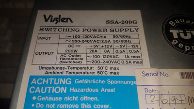

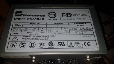

Reply 3 of 5, by cookertron
OK, I've put the old PSU back in and it starts up fine. Looking at the new PSU it's basically an ATX with an AT P8 & P9 adapter on it. The AMPs on the new PSU are higher too.
I'm concluding the higher AMPs to be the problem.
New PSU:

Old PSU:
1.2 MiB
122 views

Reply 5 of 5, by cookertron
I've fixed the problem by swapping out the fans from the new PSU to old one. Required a bit of soldering but it works fine. Quiet too!
