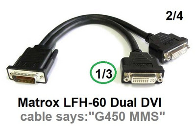

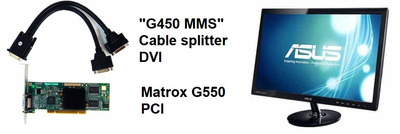

I bought this Matrox G550 PCI(mfg.2004)+cable from ebay.
It arrived with a "G450 MMS" splitter DVI cable.
- I only get black screen with this and I believe the card is faulty.
I have tried it with a modern screen=2012 Asus VS229H-P:
- 1996 P5I430VX-250 motherboard. ( Pentium 1 mmx.)
- 2006 MSI k8mm-v motherboard. ( Athlon 64 3200+.)
Anyone using this card ? How to be absolutely sure this is faulty ?
Usually these are just plug-and-play cards.
I'm thinking this card is just broken.

Reply 1 of 8, by Doornkaat
Are you getting any beeps when only using this card?
What if you're using the card as a secondary graphics card in an AGP Win2k/XP systen? Is it recognised in device manager? Can you install drivers and will it output video once the system is booted?
Reply 2 of 8, by user33331
But are these newer PCI cards like Matrox G550 compatible with a 1996 Pentium 1 mmx Win98se motherboards ?
- No beeps as far as I know.
I will try that: using as a 2nd graphic card in a AGP motherboard.
- I had only G550 installed in that 2006 motherboard without AGP card.
- I have Windows 7 in that MSI k8mm-v.
Do you think that I need WinXP for this card ?
( Are you saying G550 is not compatible with Win98se or Win7 ?)
Reply 3 of 8, by Doornkaat
I don't know about S7 motherboard compatibility of the PCI G550. It is keyed for 3.3V compatibility which indicates PCI 2.2 compliance. But that does not necessarily rule out backward compatibility.
I'm not saying you absolutely need WinXP. I was suggesting Win2k/XP because they're contemporary OS that are easy to set up with multiple graphics cards, making it easy to troubleshoot the card.
I think there are drivers for Win98, I don't know if there are Win7 drivers for it.

Reply 5 of 8, by PC Hoarder Patrol
Maybe a cabling problem, how have you got it connected? - is the splitter LFH60 to 2 x DVI-D but your screen has HDMI, DVI-I and analog DSUB. Do you have additional cables / convertors inbetween?

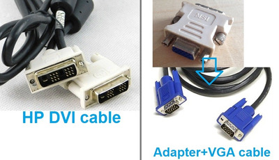

Reply 6 of 8, by user33331
Hello
Ebay seller shipped this with G550 PCI.
I tried with Asus VS229H-P(2012) screen:
-DVI cable.
-Adapter+VGA cable.

Reply 7 of 8, by H3nrik V!
FWIW, I had a G400MAX back in the day - it didn't show any image in text mode, but as soon as booted into Windows, it worked fine, scored 3DMarks as expected, etc. But until Windows loaded or in a full screen DOS-Prompt, no picture what so ever. I fixed it with a BIOS update floppy (in the blind) And I actually had a G100 failing the same way - used the same fix succesfully ..

I waited for picture maybe 2-3 min and powered PC off. Maybe I should wait until it gets to Windows.
Are there different DVI-cables ?
I used both these combinations in photo.
