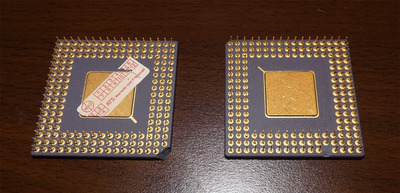

Hello, I received today a bunch of cpus with bent pins, the cpu on the subject had this pin that went of when just touched, it is the one on the keyed side.
In this page is identified as D20: http://ps-2.kev009.com/eprmhtml/eprmx/h12203.htm
In this picture is the A1: https://ptgmedia.pearsoncmg.com/images/chap3_ … nks/03fig14.gif
Any guess if it is a necessary pin or just unused?
Since in the second picture is called PLUG, I suppose it is just a pin used to keep the cpu well firmed in the socket?
Many thanks.

As you can see in the second picture there are 4 rows each side and first one there are 3 rows on each side so they are not the same pin. It is D20 in both pictures. I think that pin is in use. D0-D31 are the data pins.

It miiiight be possible to solder the pin back to the stubs I see in the hole and then covering things in epoxy to get mechanical strength necessary. That pin is essential to operation and it won't be possible to run the CPU without it.

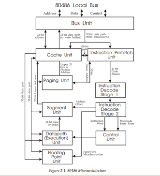

Every time cache miss occurs CPU will initiate cache line fill. On 486 cache it's 16 bytes - 4 bytes per 4 transactions. So all data lines are required to perform cache fill.

Reply 11 of 23, by BreakPoint
Actually both cache and prefetcher use all 32 data lines. So with one data line missing it should not work.

Got a 5x86 that is missing the same D20 pin and a 486 that has no W/R# pin. I don't expect them to work this way, but I'm thinking of using them for an experiment. Do you think it would be possible to remove the die cap (seems to be soldered) and maybe attach a very thin wire to the leadframe (after identifying the correct pad)?

Reply 17 of 23, by Deunan
quicknick wrote on 2020-02-27, 22:33:
There isn't a leadframe, the chip is mounted like this: https://en.wikipedia.org/wiki/File:80486dx2-large.jpg
Is it possible to attach/solder something to these pads? I guess so, but you'd better have hands more steady than a surgeon and a better eyesight as well 😀 Also, once "decapped", any dust particles would rather quickly kill the chip.
