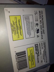

Hi,
I have a cd-rom drive with no jumper to select master/slave.
It's possible to connect to the ide controller ?
I have tested to the ide controller but it doesn't work.

Reply 1 of 9, by Cyrix200+
It could be a non-IDE/ATAPI drive, intended to connect to a propriety interface, for example a Sound Blaster card.
Do you have a brand/type or pictures of the drive?

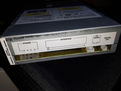

Reply 3 of 9, by Horun
oldgames79 wrote on 2020-02-28, 08:33:
Hi, […]
Hi,
If it is 40 pin and no jumpers then it is not IDE/ATAPI . It could be 40 pin Panasonic or Mitsumi. Most Sony proprietary used 34pin. We need pictures of the actual CDROM back, top, etc if you need help figuring out which one it is as FazzaGBR said.
Reply 4 of 9, by oldgames79
Cyrix200+ wrote on 2020-02-28, 09:01:
Pictures added
Reply 5 of 9, by Cyrix200+
oldgames79 wrote on 2020-03-02, 11:59:
Pictures added
The drive is an Aztech CDA-268-01a
This post says it connects to a Mitsumi connector on a sound card like the one in Horun's post: https://groups.google.com/forum/#!msg/comp.sy … V0/eOSWhe3iaf4J
It won't work on an IDE/ATAPI port.

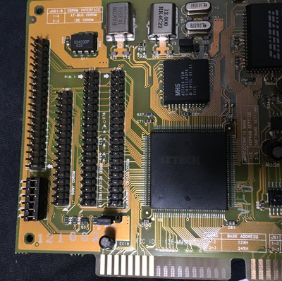

Reply 6 of 9, by FazzaGBR
Originally the Aztech optical drive would have come with an Aztech Sound Card that would have had the interface on it to which you connected the drive to. As others have indicated, it's not designed to work on a standard IDE/ATAPI port I'm afraid so you better get hunting for the sound card!

Reply 8 of 9, by FazzaGBR
derSammler wrote on 2020-03-04, 12:29:
Aztech did not make its own interface, so there's no need to find an Aztech card for it. It's either Mitsumi or Panasonic, which were the interfaces on Aztech cards as well.
Perhaps it's just me then but I think it would look nicer in the case if it matched! 😀
