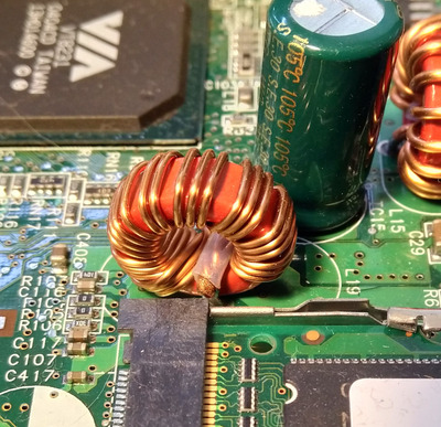

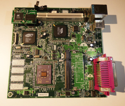

Got this today rather cheap, I think it's similar to the board described here.
Unfortunately it was cannibalized for parts, so most of the electrolytic caps and the three big inductors are missing (along with the audio and power jacks, but these are easy to replace). So if someone has this board I'd very much want to know the values of TC4, 8, 9, 11, 12, 15, and maybe some rough estimates on wire gauge/number of turns for L12, L15 and L19.
Thanks in advance!

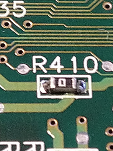

Edit: there's also a missing SMD resistor on the back side, R410, right below the flash bios chip... 🙁

I'm not too hot at identifying inductors or SMD resistors, so here's some pics instead:
L12 (identical to L15):

L19:

R410:

However here I found it described as Acer P558 M/B 02157-1 48.3B201.011 Thin Client mITX Motherboard TM5800 733MHz CPU

The inductors are low pass filters, removing high frequency ripple. Anything reasonably similar in terms of winding length, turns, coil area, wire gauge and core material should be close enough and do the job. Basically, if they look identical, they'll be electrically identical too. Also, it's not all the world if the inductance is a little bit off in that application. Perhaps you could even get away with a simple jumper wire as replacement.

R410 is a zero ohm resistor. It's basically a jumper in a package that a soldering robot can handle. Can be replaced with a solder bridge or a piece of wire 😀

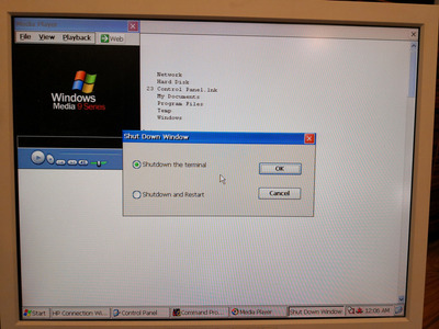

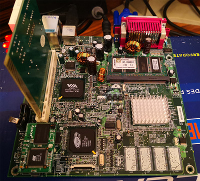

Well, it works. Thank you again dionb. Now I'll have to find some use for it.
What I find amazing is the amount of heat this CPU generates (or rather doesn't). The original heatsink and spring clamp are missing, so I've used what you can see in the picture, attached only with a dab of thermal paste. Barely gets warm to the touch.
