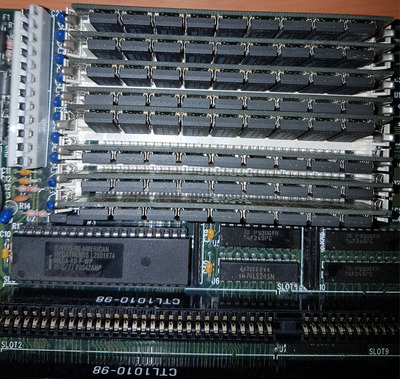

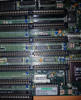

Reply 4 of 22, by eeJay
Well, after swapping the battery for a CR2032, the "Enter CURRENT password:" message still shows up.
I even unplugged the IDE/FDD controller card - no change, so it's definitely a BIOS lock.
There are a few pics of the board in the attachment. The BIOS chip is AMIBIOS 386DX ISA BIOS 1992 AA1078870.
Do you guys have any other ideas on how to bypass the password?
Thanks and br

Reply 9 of 22, by Predator99
Usually 24h should be enough.
There is also some green corrosion damage left under the battery. But I dont think thats the reason for your problem.
Wait some days. If it doesnt work, you should think about getting a programmer. Its likely the message also appears with the other BIOS.

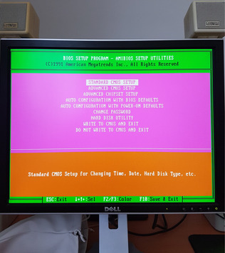

Reply 18 of 22, by eeJay
Patience does pay off! Letting the PC sit without the battery for 48 hours or so did the trick.
Thank you guys for all you help. Now, there are a few more things I have to set up - enter the HDD data, somehow reverse the 7-segment display (it now shows 20 MHz when it should be 40), check that continuity/corrosion etc.
Couldn't be happier!
Reply 19 of 22, by eeJay
Well, the 7-segment display showing the wrong value could be easily remedied by changing System Boot Up CPU Speed to Low. And then pressing the turbo button would bring it to 40, so an inverse turbo of some kind.

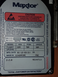

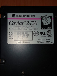

As for the hard drives, I have the following information:
One is a Maxtor, no set-up data on the label (probably the boot drive). The other one is a WD; set-up data is on the label (shouldn't be a problem to set up, but probably isn't the boot drive).
Any ideas on what values to use in CMOS for that Maxtor drive?
