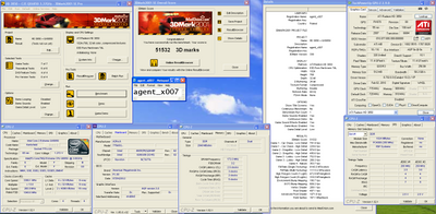

Biggest problem with ASRock AGP/PCIe boards on Quads is massive Vdroop/no LLC, and FSB limitations.
256MHz (real clock), is usually required for full stability (stock) and -0,1V Vcore drop under load doesn't help OC'ing.
As for 775i65... I own 3.0 version.

Well, I don't have BIOS setting saved (and system itself was assembled just for testing - it's in parts currently). Regardless, you have most important things I ran in screenshot I provided (FSB, DRAM, timings, AGP speed [SBA]). BIOS I used is the official one.
Still, keep in mind my HD 3850 was OC'ed model, so you probably won't reach my results on "stock" model.
