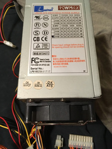

Reply 5 of 6, by Horun
I have a few retail ATX PSU from the late 90's to early 2000's and all during that time had -5v and -12v. There are still some made like this one at Amazon:
https://www.amazon.com/Coolmax-I-500-500W-Pow … /dp/B0081H7EDK/
But many new ones do not have the -5v and or -12v
A picture of one of my older 20pin ATX PSU for testing motherboards
