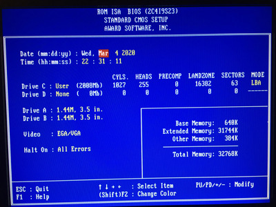

Okay, I ran into the same problem as the previous time I tried to partition this disk. So I set up my BIOS to autodetect the drive, and it results in this setup:
1.85 MiB
113 views

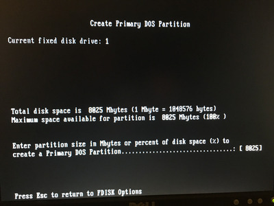

But when I try to partition the drive, FDISK from Windows 95 sees the drive like it is 8 GB:

So previously I "winged" it with the config I posted in the opening post, but now my BIOS give a hard disk failure. Has anybody an idea what I could do to properly setup the drive?

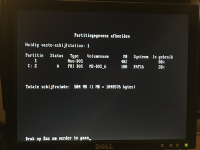

I tried setting up two partitions with the NORMAL option in the BIOS, but FDISK only sees 504 MBs of the drive, and when I run the speedsys test I can see speedsys only sees 1023 cylinders of the 16000+.
