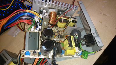

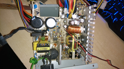

I have a Hipro HP-M1554F3P (IBM 00NN7687) power supply I got for free.
The moment it arrived I noticed that it smells like it was rescued from fire. The usual electronic burn. I tested it anyway and it runs stable. I tested voltages under load, all good.
I opened it to find the burned parts but found nothing. No burns on the component side, nothing on the solder side. It was never opened before, the warranty seal was intact. So what could be the source of that smell? I suspect one of the transformers from a previous overload (mainly the one with the Danger sign) but can't confirm.
What are your thoughts?

Reply 1 of 15, by Deunan
Could be the dust burning, I'd suggest you treat it with some compressed air or a brush to clean it up. Preferably both (air, brush, air again).
Also, are you sure it was the PSU that gave the smell? Look for any vented caps on the mobo, and if it has any tantalum capacitors (or any of the add-on cards have them) inspect those as well.
Reply 2 of 15, by IBMFan
It was fairly clean but I'll clean it anyway. I only have this PSU, no other parts of the original PC.
As you can see there is that white glue everywhere they used to keep the parts in place. That could be the culprit, I don't know.
Everything else seems intact and the smell is so strong that it's impossible to find the source.
When I tested it the temperature was fine, barely warm to the touch. Strange.
Reply 3 of 15, by Deunan
Oh, I misunderstood, I thought you tested it with a mobo you already had.
Well, it looks OK-ish, nothing obviously wrong with it other than being old PSU. Even the line noise suppresion parts are all there so it's not the cheapest variant that could be made. Maybe it just has that kind of smell, or maybe it was in a machine that blew a cap and the fan sucked all that in through the PSU. I wouldn't worry if it works and nothing bad happens, these rarely die slowly so you'll know when it goes 😀 Also, the glue is fine and I've seen it used, shouldn't have any smell to it.

Reply 13 of 15, by IBMFan
I managed to get another PSU of the exact same model so I decided to go "all the way" on this one.
First I washed it under water and scrubbed the panel with a toothbrush. Applied a little dish detergent too. It didn't do much in regard to the smell so I took it completely apart and dunked each part in 20% vinegar for an hour.
After that I washed everything again for a few minutes and dried it for 2 days on the radiator.
It looks like new, no corrosion of any kind but the smell is still there! Not that strong but it's definitely noticeable.
The PSU works like a charm but I failed to get the smell out.
It seems that burnt plastic smell is nearly impossible to get rid of even when I do crazy things with it. Or it needs way more time in the vinegar bath.
Maybe if I dunked it in perfume... but it would probably smell like burnt plastic AND perfume forever.
On the other hand it was a great way to debunk a few myths.
Short-term water and vinegar exposure has no corrosive effect on any of the panels, parts or the PSU case (ON THIS MODEL).
All labels have to be removed beforehand.
It doesn't take 1-2 weeks to dry the PSU like a few websites mentioned, it took 2 days at most on a radiator. I'm almost certain that 1 day would have been enough but I wanted to make sure.
Vinegar smells bad but it doesn't actually remove other bad smells like I expected. It just adds to the bad smell that you have to get rid of under running water. It helped but the extra work/risk was NOT worth it.
We should come up with a safe mix to get rid of strong smells without damaging the parts and circuits.
Thanks for all the suggestions.
