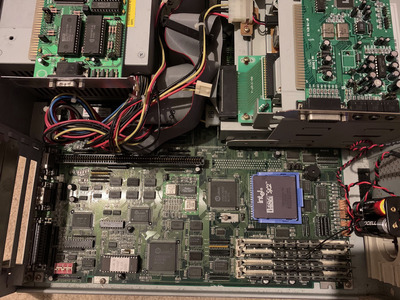

Hello all.
I have a 486 system I enjoy using but would really like it to upgrade it to the best it can be (before costs become silly)
although my first pc was a 486 I am still fairly unfamiliar with the differing socket types and requirements etc.

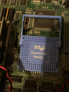

I blindly got a 486 dx4 100 for it without even thinking about sockets or voltages. I have since checked and the curent sx50 is a 5v chip and the dx4 a 3v. There are no voltage jumpers on the board so I wont be able to use it.
What cpu would I be able to upgrade to on this system? The board has settings for up to a dx2 66 but the socket says it can accept overdrive chips. Something I have never seen in person before.
The usage of this machine is DOS and early windows games. Windows 95 is installed and as expected it isnt exactly snappy.
I have since found JP6 which the case just labels "Default pins 1-2". It does not describe what the jumper is used for. Could potentially be a voltage switch?! The PC is a trigem 486/33mm and hard to locate any information about other than what is printed on the case.

Reply 1 of 32, by Tiido
Take a photo of the entire board, if no voltage regulator is visible anywhere the board is likely 5V only.
Reply 2 of 32, by dionb
Assuming 5V only, the fastest easily/cheaply available CPU is 486DX2-66.
As for exotic stuff...
- Intel's DX4 overdrive is basically an i486DX4-100 with built-in 5V-3.3V converter. It would let you do 100MHz.
- Evergreen, Kingston and various other vendors made similar upgrade modules with DX4-100 and DX5/5x86-133 CPUs
- With a generic voltage converting interposers you can stick a 3.3V or 3.45V CPU on a 5V board. That would let you use an Am5x86-133.
Cyrix CPUs need more specific settings, if not present on the board they probably won't work. Despite the socket loudly proclaiming Overdrive compatibility, it can't handle the physically bigger Pentium Overdrive (PODP-83) .

Reply 4 of 32, by Tiido
It doesn't seem this board has a voltage regulator (usually a 3 legged part attached to a heatsink) so 3V CPUs aren't supported. Dionb has presented options to explore.

Reply 6 of 32, by derSammler
LewisRaz wrote on 2020-03-06, 23:20:
That's a 5V DX4-100 Overdrive CPU. They shouldn't be that hard to find on ebay and the like.

Reply 10 of 32, by derSammler
Really? The two I see there are both the ones you need. If in doubt, check cpu-world.com:
http://www.cpu-world.com/sspec/SU/SU004.html
http://www.cpu-world.com/sspec/SZ/SZ959.html
Both are PGA168.

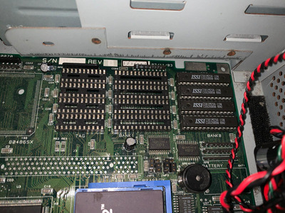

Reply 18 of 32, by LewisRaz
After thinking about this system I decided to take a look at the cache area and it was unpopulated so I thought I would add some chips from a dead socket 7 system.
One thing I am unsure of is the TAG chips. These are not present on the socket 7 system. Underneath the socket it is asking for 16K x 4 and it is a dip22 socket. a quick search online locates these for sale in germany: "CY7C164-15PC"
My question is would those be suitable and how many would I need? I do have 4 more matching cache chips to go with the ones I have already added if I wanted to.
I am mostly bewildered by this add-in cache business but am trying to learn what I can from past threads on this forum!
I do plan to add a dx4 overdrive when/if I find one for a better price than currently available.
Thanks

Reply 19 of 32, by CoffeeOne
LewisRaz wrote on 2020-03-08, 22:22:
After thinking about this system I decided to take a look at the cache area and it was unpopulated so I thought I would add some […]
Thanks
Lewis
Now I must comment on that 😁
Has that board 4 Tag RAM chips?
I never have seen such a board. Or maybe just 2 tag rams, but what are the other 2 sockets then?
Can you make a photograph of the cache area where we can see the writing?
Another remark:
You seem to have 4 pieces of 32x8 cache srams, so it would be 128kB L2 cache
But when you have NO tag/alter ram chips, you have in fact zero L2 cache.
You don't have that board for a long time, do you? Somebody has removed the tag rams 😁
