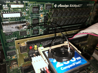

Did you try using some contact cleaner on the Lock / Normal switch ? Also maybe re-clean the ISA contacts ...

No not a Rampat, mine is an old IBM AT 16bit XMA/EMS memory card. The Rampat docs say you must use 9 chip 80nS or faster simms. And for two simms use top two sockets.

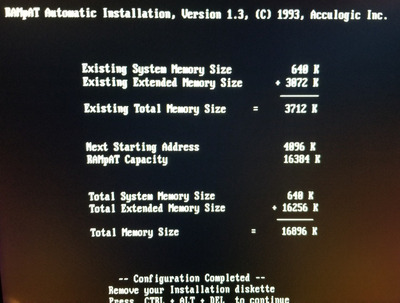

A picture shows the driver screen and "Next Starting Address". Is the driver configurable ? Maybe it needs a specific config.sys line ? I am stumped.
Reply 26 of 48, by Predator99
The driver comes as a boot disk. It loads really quick without a config.sys or autoexec.bat. There is no option and no kind of interaction. It just shows the screen (screenshot on the top of the thread) and asks to reboot.
You can also load the config program from DOS. But there are no command line options, too. I have read somewhere that one should use the bootdisk.

Thanks a lot for these. Looks like you need to a 720K or 360K diskette for Winimage to write these images. There is a way to convert a 1.44M diskette into a 720K disk, which I already have from years ago. I wrote the v1.3 diskette and it booted right away. It looks like it does is run config.com.
I tried the v1.1, v1.2, and v1.3 of config.com that you have provided, but in every case, it shows the RAMpAT capacity at 0 K. It does correctly identify the next starting address, which in my case is 16384K.

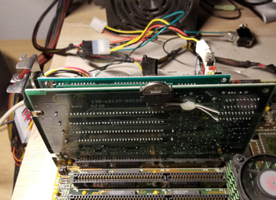

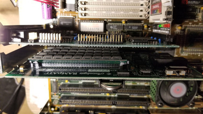

This is how i use the RAM controller.
The config.com can be run from regular DOS prompt, you don't need a bootable diskette.
It works well with 4Mb of installed system memory (in the motherboard slots).
With 16Mb of installed system memory the RAMPath config utility shows 0Mb capacity.
May test later with different size of system memory on a 486 machine, but this device controller makes sense for 286 class hardware only.

The motherboard i tested with (in the pics above) the RAM limit is 32Mb.
Used the card successfully in 286 machines.
