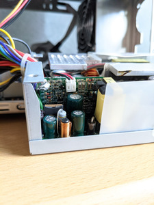

I think I have to change the cap.
470μF 16V
https://www.conrad.de/de/search.html?search=4 … ial%20bedrahtet
What do you think about this one? the right one?
Panasonic EEUFC1C471B Elektrolyt-Kondensator radial bedrahtet 5 mm 470 µF 16 V/DC 20 % (Ø x H) 10 mm x 12.5 mm 1 St.

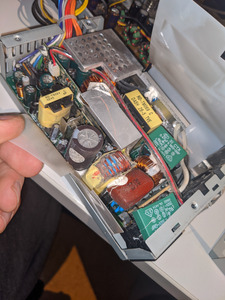

Reply 1 of 3, by Horun
The large brown capacitor should be on the primary and those rarely fail. Those small green ones near your thumb are the type that typically fail in PSU but do not see any leakage or bulging from the middle picture camera angle.

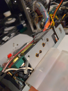

Reply 2 of 3, by GokuSS4
this one doesnt look good

Reply 3 of 3, by Horun
Yep the dome is showing 😁
