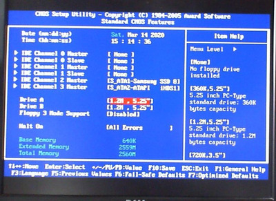

Reply 1 of 17, by red-ray
The BIOS of my Gigabyte 8IPE775P allows 2 x 5¼", but I don't have any 5¼" to confirm this works.
The system uses the Intel 82865PE MCH + 82801EB (ICH5) and I have an Intel Pentium 4 640 (Prescott 2M) CPU
    80.59 KiB
    1081 views

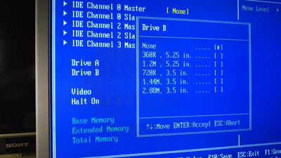

Reply 14 of 17, by imi
I just checked my GME965 / ICH8M industrial board and it lets me select pretty much everything :3
the floppy is connected to a Winbond W83627DHG super I/O controller though, so I guess that's not really dependent on the chipset.
116.05 KiB
752 views
