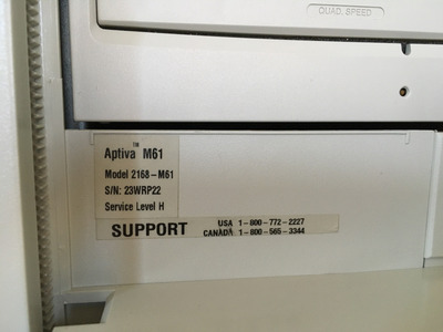

I recently purchased a 1995 IBM Aptiva 2168 Model M61 (120 MHz) in great condition on Craigslist, and I have been attempting to get it set up with Windows 95 to play some classic games from my childhood.

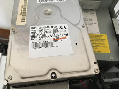

The problem is that I can't seem to get any operating system installed on it. The original owner removed the hard drive, and I bought a period correct IBM replacement (3.2 GB IDE) which is recognized by the machine. As an aside, there are no errors in the POST and everything seems to be connected properly to my eyes upon internal inspection.

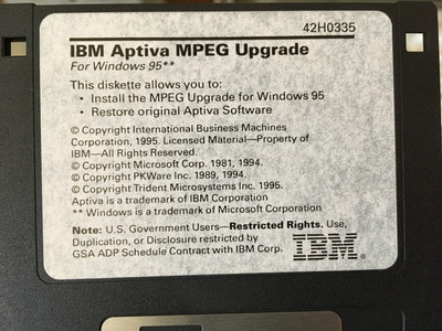

I received seemingly all of the manuals and recovery materials from the seller, including the IBM Aptiva Recovery CD, but the machine doesn't recognize the CD drive without drivers currently. In the manual for the recovery CD it states, "You will need to make a recovery diskette to use the backup software on the CD." To my knowledge, I don't have a 1.44MB recovery diskette, although I do have a mail-in "IBM Aptiva MPEG Upgrade" diskette which according to the diskette label allows one to "Restore original Aptiva Software" (see images below). I've tried using it, and it appears to load the CD drivers, but then the software tells me that the Windows 95 license has expired and that I need to insert a Windows 95 disk. When I insert an official Windows 95 startup disk, the computer still doesn't appear to recognize the disk in the tray, even though the drive lights up. This is as far as I've gotten with that method.

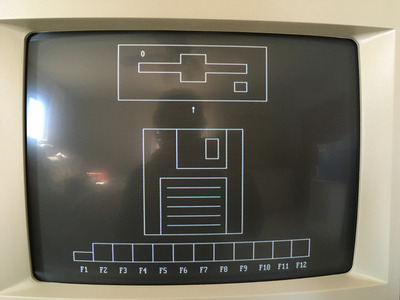

Biggest Issue:
Currently, immediately following startup I get the floppy image, and whenever I try to load any of the diskettes mentioned above and press F1, the computer beeps and reloads the screen telling me to insert a floppy disk. It doesn't seem to matter what diskette I put in there; the end result is the same (thus I cannot even recreate what I wrote above). Does anyone know how to circumvent this and/or what do do in general? I apologize for the novel, but I've been a Mac user for over a decade now, and so I'm not that familiar with the Windows/IBM ecosystem and workflow, especially when it comes to older hardware.

Reply 1 of 1, by feipoa
Have you tried a different hard drive, or confirmed that the hard drive is functional in another system? These old hard drives are doomed for failure.
Did you try booting the system with a standard DOS start-up disk, e.g. the kind that are created in Windows 95/98 and formatting the hard drive using fdisk and then format c:?
If you enter the BIOS, does the system recognise the HDD and are the HDD parameters set correctly?
Does the board use a Dallas RTC module which needs to be replaced? How about the BIOS battery on the board - still good?

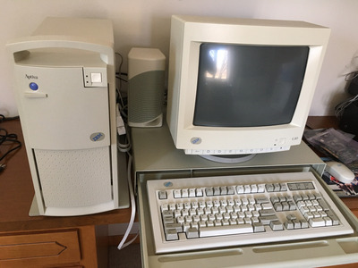

On another note, that is one very attractive looking system. I've always had a thing for these old Aptiva towers.
