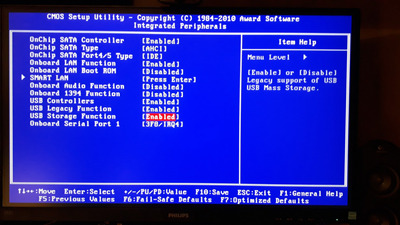

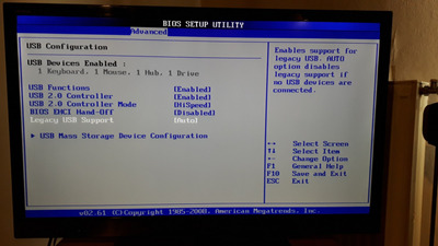

Reply 10 of 14, by Falcosoft
derSammler wrote on 2020-03-17, 07:44:
Legacy mode is for keyboard and mouse only, which appear as ps/2 devices then.
Sometimes yes, but not necessarily/not only.
241.5 KiB
8748 views
E.g. contrary to the above with this board 'Legacy USB Support' also refers to USB Mass Storage Devices. If you disable 'Legacy USB Support' USB drives are also disabled and you cannot even boot from them:
179.2 KiB
8732 views
Actually if you can boot from USB drives then your BIOS supports USB Mass storage devices as regular drives and no further drivers required regardless of OS. You only have to make sure that used file system is supported by your OS (in case of DOS it's FAT16/32).
