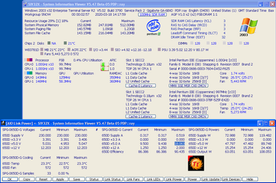

Reply 6 of 11, by red-ray
I feel the sensible option is to get a PSU that reports how much current is actually used. Below you can see my Dual P-III uses just over 18 amps @ +5 so I expect a 17 amp @+5 PSU would be fine for a single P-III system.
file.php?id=79081
The PSU I am using is good for 20 amps @ +5, see https://thermaltake.azureedge.net/pub/media/p … 7fbd038ec81.pdf
    48.8 KiB
    372 views
    18 amps @ +5
