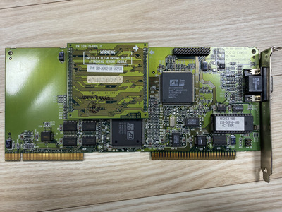

I checked my VLB Winturbo and VLB Graphics Pro Turbo, it seems both equipped 68860. I have not seen any Mach64 with IBM RGB514 ramdac and wonder what’s the difference between those two ramdacs.
At first I thought I installed wrong windows driver , and after seeking some infos including aboves I guess 1280*1024 is original limit of driver of normal Graphics Pro Turbo. (According to VOGONS WIKI there is no Graphics Pro Turbo 1600 VLB) Windows98SE default driver may be the one that those two drivers are incorporated into.
Then could we infer ATI intentionally set resolution limit for Graphics Pro Turbo and actually two ramdacs have little difference ? Normal ATI Mach64 Graphics Pro Turbo using ATI68860 ramdac also has no problem in using 1600*1200*16bit?

* Attached is my ATI Mach64 Graphics Pro Turbo 4MB VLB

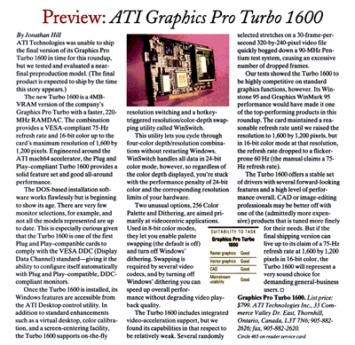

However, ATI68860 is the part from regular Winturbo/Pro Turbo and I have it on several non-1600 Mach64GX cards. Are you sure it is actually 220 MHz DAC and it is the card that was shipped in that box? Does it support 1600x1200 @ 75 Hz? Another thing that in manual they claim the only card to support DDC1 is the 1600.
This article from PCM clearly shows GPT1600 with IBM DAC:
303.34 KiB
264 views
But as you said it could be they launched with IBM and scaled up their own DAC later.

I stumbled across this article during my research aswell but the photo seems to show just a promo picture for the press. I'm pretty certain mine is the original that was shipped in the box as it would make no sense to replace a GPT with a GPT 1600. Both cards were hugely expensive around 1995/1996 and the benefits of this upgrade path were marginal. I also need to add that my example is a very early one (early 1995) with Windows 95 compatibility advertisement so a late revision 68860 could be out of question.
PC Mag (Dec 95 issue) also claims the Spectra DAC has 135 MHz while RGB from Amoretro says it is a 200 MHz RAMDAC. The truth must be somewhere along those lines.

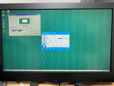

I just tested my Graphics Pro Turbo VLB with Windows 98SE default driver. It displays up to 1600*1200*16bit at 54Hz.
* This monitor is small 12in. LCD monitor. I use this for simple testing because it is handy and capable of display 15kHz.
