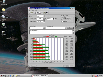

Hi folks - I wonder if you have any advice for an odd issue. Pentium III 450MHz machine with Windows 98SE, 256MB ram, 80GB IDE hard disk and 3Com 3c905c-tx 10/100 PCI network card. I was copying files over to this PC from my modern machine and noticed that the transfers were really slow. Transfer of even a single large file goes no faster than 1.5 MB per second at the most according to the Windows 10 source machine, and the time it takes seems to confirm that figure is about right. Copying from the P3 to the modern machine I see 3MB per second, suggesting that writing on the P3 machine is part of the issue, but perhaps not all of it.
I've tried some basic things - swapping out the network cable made no difference. I ran a benchmark on the hard disk and for larger writes it's capable of writing 10 to 20 MB per second. The network card is the only PCI card in the machine, so I don't think it's a bus bandwidth limitation. PCI should be capable of up to 133MB per second, right? I do have a different network card I could try but haven't done so yet.
Where's the bottleneck likely to be? Am I expecting too much of this machine and/or OS?

With a 10/100 PCI network card, you are limited to 1.25 MB/s (when connected with 10 mbit/s) or 12.5 MB/s (when connected with 100 mbit/s). This is the raw bandwidth and does not account for any overhead. In reality, you can't get much more than 80% of that. So given that you have a 100 mbit/s connection, this would be 10 MB/s. But Windows 9x is very, very bad when it comes to networking. It's just not fast. Even Windows NT and Server was often criticized for that, it simply can't make full use of the bandwidth.
You can check if you can enable DMA for the 3Com card in the device manager, if not already enabled. And use the 3Com driver for the card. But apart from that, there's not much you can do to speed up networking in Win9x.

Hard disk has DMA checkbox enabled...I'm sure there used to be somewhere in Windows 98's Device Manager that would tell your the current UDMA or PIO mode on each drive, but I can't seem to find it now. The benchmark numbers do feel pretty slow, but I don't remember quite how fast drives were back then. This 80GB drive is at least a few years newer than the rest of this machine though.
The NIC seems to have the offical 3Com driver installed, no settings to tweak in there though.
I'm not sure how to see CPU load in Windows 98 - Googling it lead me to 3rd party programs and forum posts saying that they don't measure CPU load very well in Windows 98.

Not sure why I didn't think of this before, but I tried repeating the same test on my overkill Windows 98 machine which has a faster hard disk and Athlon 64 CPU. It was able to pull 3MB per second over the network, which isn't a whole lot better. I'm willing to accept the "It's just Windows 98" explanation.

My P3-450 on Asus P2B-LS with integrated Intel Pro/100 can get 5-7MB/s download from FTP with cpu utilization around 80%. I have similar experience with D-Link DFE-530TX. And TCP Optimizer actually made it little worse. I read here at Vogons that Intel Pro/1000 GT might give faster results , around 100mbps on 1gb link, but I didnt try that. Problem is Windows 98's network stack. In Linux or XP its actually possible to get to 12MB/s on 100mbps. Trick is in disabling interrupt moderation in card's settings.

Windows 98 is really inefficient at SMB transfers (Windows file sharing). The PIII will bottleneck it but even you you had a Core 2 in there it wouldn't be great compared to XP or newer. XP is also slower than Vista+ but this is only a problem with gigabit rates.
One tweak I've seen improve speeds a little is disabling interrupt moderation on the NIC so it can freely blast the CPU for all it's worth. Maybe this indicates SMB is using tiny transfers that are inefficient with high bandwidth rate.
