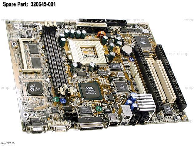

Are you sure you actually have an AGP slot? My quick google seems to indicate that the Presario 5284 does not. The AGP 2x is for the integrated video (Rage Pro LT) only.
I'm guessing you will be looking at PCI upgrade options, and your probably better with something a little older than Radeon 7000 or FX 5200 due to driver overhead. Something 3dfx (Voodoo3) would probably be ideal, but then you might be spending more than you would like. Like you suggested, the TNT2 would probably be a great option too. There will be little added benefit, but I'm guessing a PCI Geforce2 MX would be an easier card for you to find.

Reply 4 of 12, by BinaryDemon
brian105 wrote on 2020-04-17, 15:05:
I believe I saw an AGP slot near the PCI slots. Black, a bit smaller than a PCI slot?
Your description sounds right, although I think often a different color like brown or dark purple is used to differentiate agp.
I was going by this picture: https://651c328d1de292af2c4b-28651361a0deac96 … /320645-001.jpg
And cnets description:
Slots
1 (total) / 1 (free) x ISA
1 (total) / 1 (free) x PCI
1 (total) / 0 (free) x shared PCI / ISA

Reply 5 of 12, by brian105
Hmm, you're right, I just checked again. What are the big black slots near the PCI slots then?

Reply 6 of 12, by dionb
brian105 wrote on 2020-04-17, 21:44:
ISA. Great for DOS sound cards. Less so for K6/2-era video cards.
